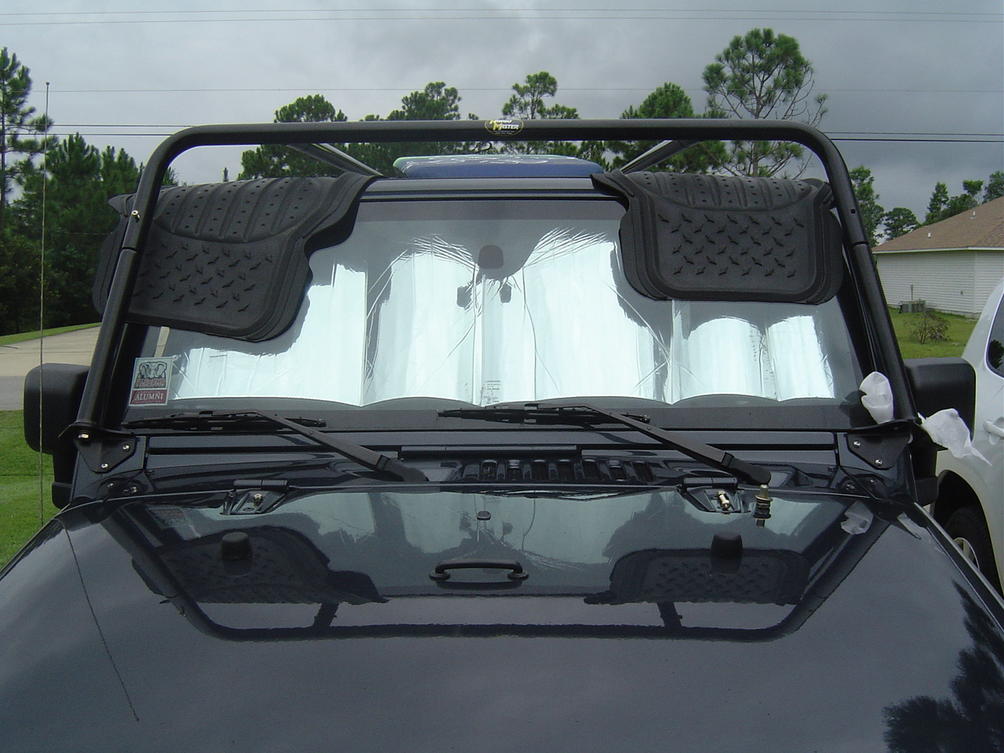

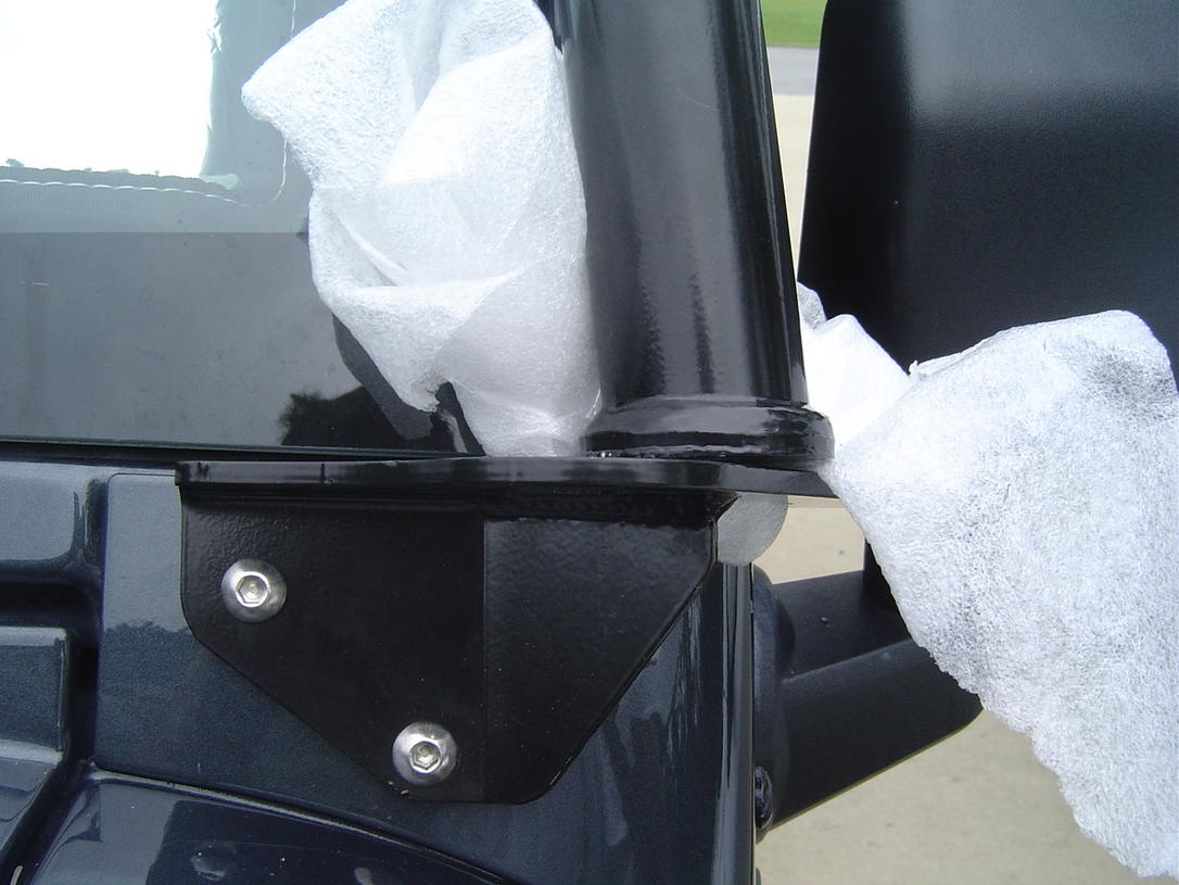

This took way too long. I have a problem with my front u bar that goes over the front seat. It's either too wide or is not bent enough to line up with the windshield mounting brackets. This is a problem I have not heard of. I made sure I didn't get the front and rear u-bars mixed up. One side is about an inch too wide to fit righ on the bounting bracket. I'm posting pictures. My wife and I had to muscle it on, but there's a lot of unnecessary stress on that bolt. I've contacted KM about a replacement piece. I'm going on vacation tomorrow, so I'll post more about it in a week. For now, here's some photos of the problem:

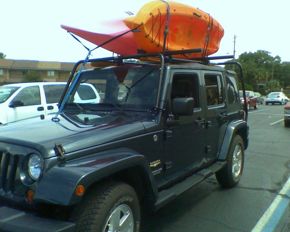

I did take the soft top completely off w/o having to tilt the top back. I assume that I should be able to put it down w/o taking the top off. The only problem is that I often run it in sunrider mode as I have to quickly put the top up for the T-Storms we get out of no-where here in the panhandle.
As far as the problem I have with my front u-bar being too wide, Marsceles over at KM is also hooking me up and is shipping me a new part.
The rack worked great for the kayaks on the road trip. The only problem is that the Thule kayak stackers I took off my 01 XTerra don't work well with the round bars, so I'll have to get some hully rollers from yakima. I attached a pic (the pink one is the wife's).
As far as the wind noise...just take off the top and doors and it goes away
