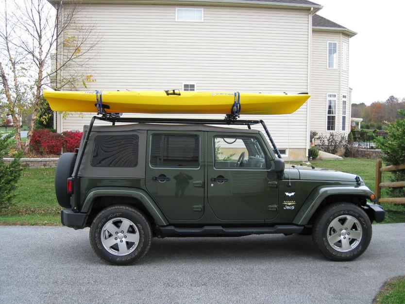

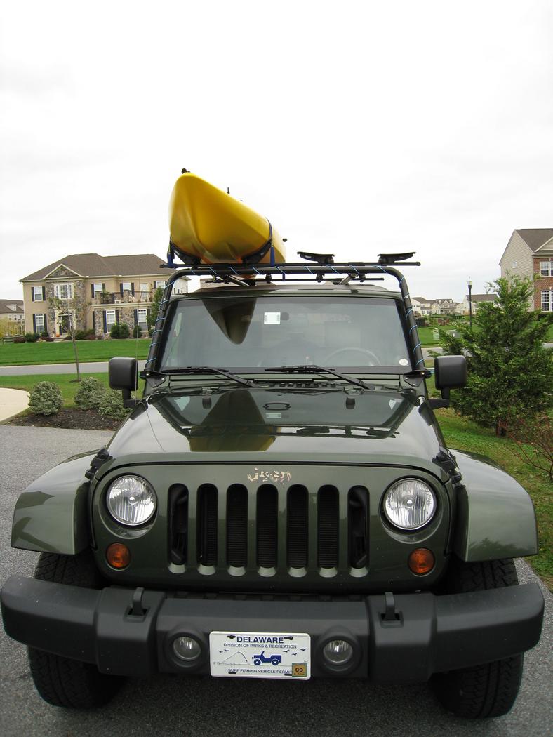

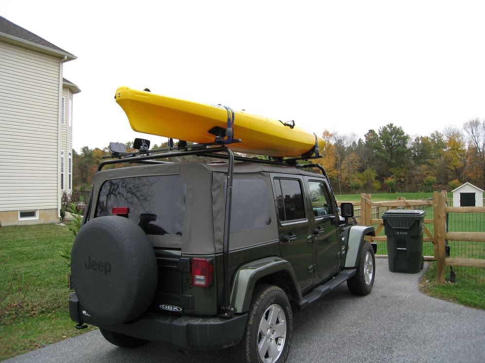

Default Kayak on the kargomaster using thule racks
Some pictures of the rack in use, I usually carry two kayaks
