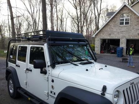

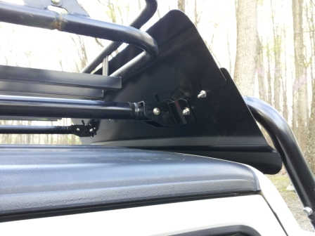

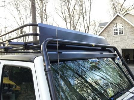

Default New Wind Deflector
I didn't see this option talked about on here and just installed one myself. Thought some would be interested.
I purchased this Wind Deflector from buyautotruckaccessories.com and the SKU is 60161 (hard to find on their website, it's a little clunky).
After installation, I would say it cuts the wind noise down by 40%. I haven't driven with tops off yet but it certainly makes a difference in my day to day commute. It went on easily enough but encountered the same problem I had with the cage itself, shoddy directions. It runs flat across the front of the headliner and it would have been smart to 'bend' it a bit so the rubber seal (along the bottom) was snugged up across the entire front and flush. However, there are a few channels in the lower part of the piece and that would have made it difficult. The accessory comes with an additional wind screen 'lifter' that bolts on the top (3 bolts) and gives you clearance up to the top of the basket (any cargo in the basket will stick up above the deflector). The directions call for cutting the two rubber grommets that go around your tubes but, I took the front tubes apart and slid the grommets on (wasn't much additional work and gave me a chance to check for rust).
Anyway, for 150.00 (shipping was free), I thought it was a no-brainer. Really cut my noise issue and like the look of it. Will probably get some custom grafix done to throw up there as well.
Bonne chance mes amis.
