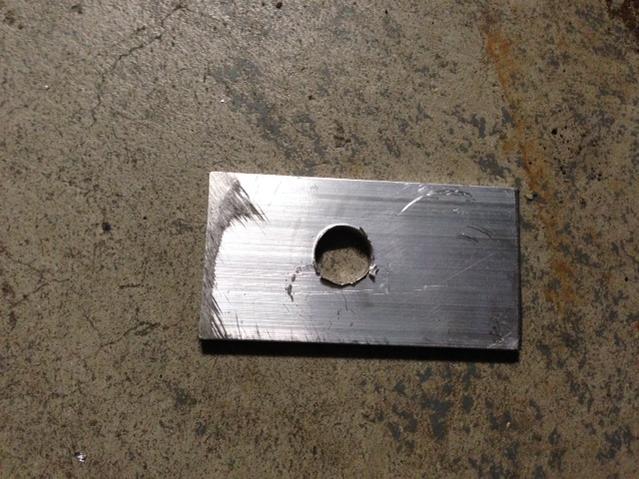

Brilliant mod. I used 1/8" aluminum flat stock cut to 2.5" long and played with the shims until I found the right comfort level. Ended up with 3 (3/8") in the back and 1 (1/8") in the front.
Attachment 526539
The kids love it so far!
So are you saying you added 3/8" height to the back and only 1/8" height to the front?
If you could get longer bolts ect. What does everyone think would be the optimal height added to each?
And yes using flat bar and not washers.
Could I get away with 1" on each front/rear? I'm looking to create a bucket seat style recline with seat bottom to match recline.
Todd

So are you saying you added 3/8" height to the back and only 1/8" height to the front? If you could get longer bolts ect. What does everyone think would be the optimal height added to each? And yes using flat bar and not washers. Could I get away with 1" on each front/rear? I'm looking to create a bucket seat style recline with seat bottom to match recline. Todd
Yup. I played with the shims to get what my kids thought was the most comfortable seat. And it feels great.
I think you can get close to 1" each, but it may start to bind. Only one way to find out.
