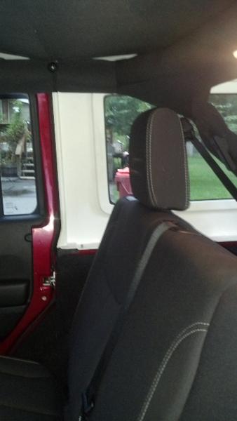

Before

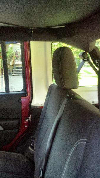

After

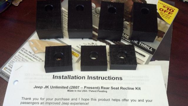

Found this spacer kit on eBay...

Easy install took about an hour maybe a bit longer. Hardest part was tightening the front legs back down while keeping them straight and not twisting. If they twist the seats won't fold down right.
The kids agree its way more comfortable than before. :-)
