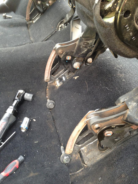

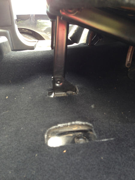

Finished my mod. Ended up with 6 washers stacked in the back and 8 in the front. Going to go ahead and replace the bolts with ones longer to make up the difference.

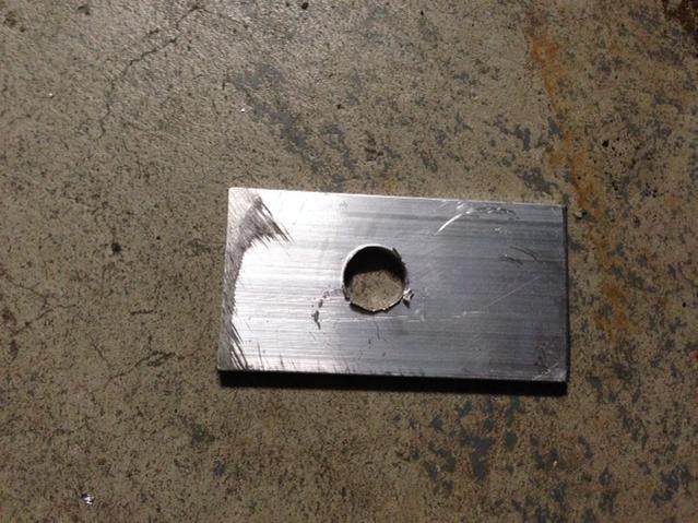

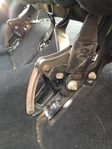

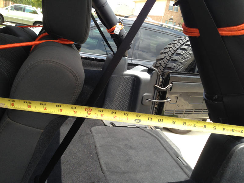

Ive had a ton of complaints from buddies about comfort in the rear seat. So this was a huge help. I used aluminum flat stock a 1/4 inch thick. Four pieces in the front measuring 1 1/2 inch wide by 2 1/2 Long. I traced the hole locations for front and rear brackets once I removed the bolts. I used 1/4 inch aluminum for the rear brackets also. Those back brackets measured 2 inches wide by 4 inches long. Took alot of effort to break the bolts loose, my aircompressor acted up and I got stuck using a 16 inch rachet. Befor the mod I had about 11 inches from the back of the headrest to the soft top bracket on the cage, after the mod I had about 9 1/2 inches. Small but noticable. Thanks for figuring this out guys!!

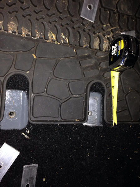

Old Jan 26, 2014 | 01:13 PM
  #127
Asinine's Avatar
Posts: 292
From: Santa Clara, CA
Brilliant mod. I used 1/8" aluminum flat stock cut to 2.5" long and played with the shims until I found the right comfort level. Ended up with 3 (3/8") in the back and 1 (1/8") in the front.

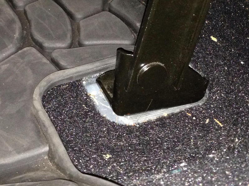

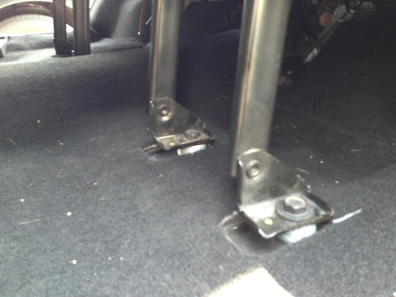

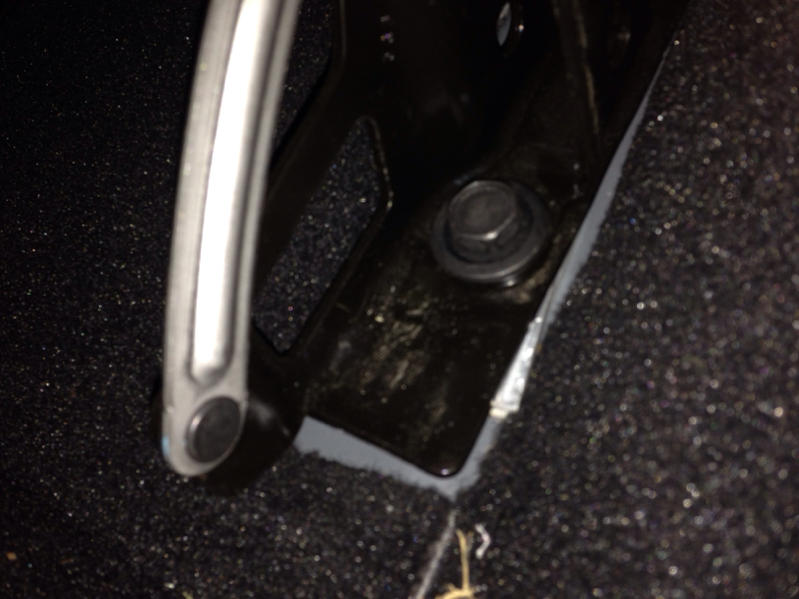

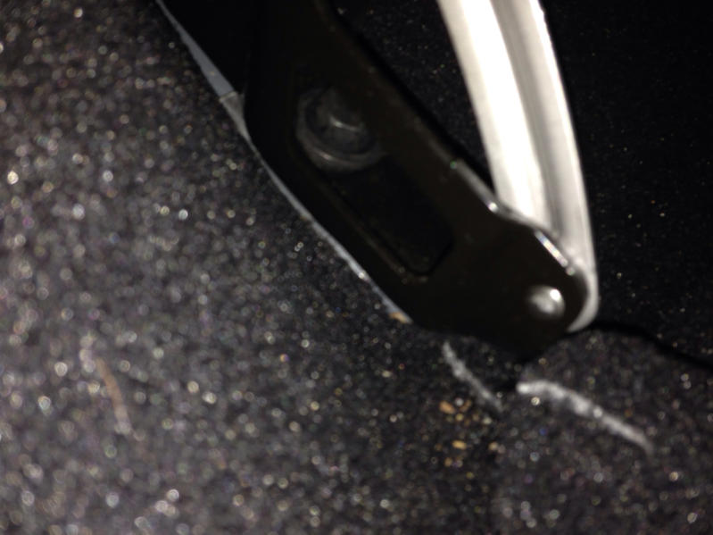

if you have time, would you (Asinine) please post a few pics of the final results at the front and rear mount. Thank you
Old Feb 2, 2014 | 08:36 PM
  #129
Asinine's Avatar
Posts: 292
Not easily without pulling the seat up again. Here are a few shots:
