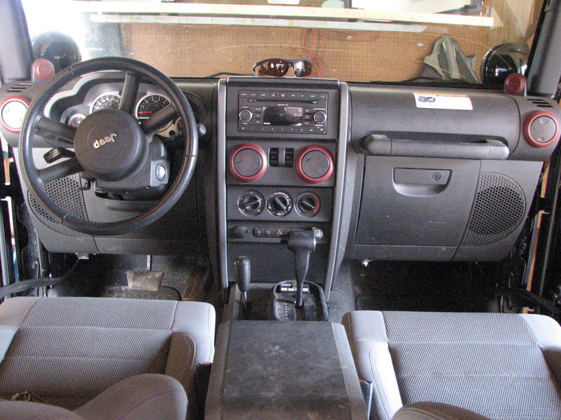

Default Six dollar dash upgrade
I just did mine too. I guess i should have cleaned up the Jeep before taking the pics.
Name:	Jeep 3.0 018..jpg

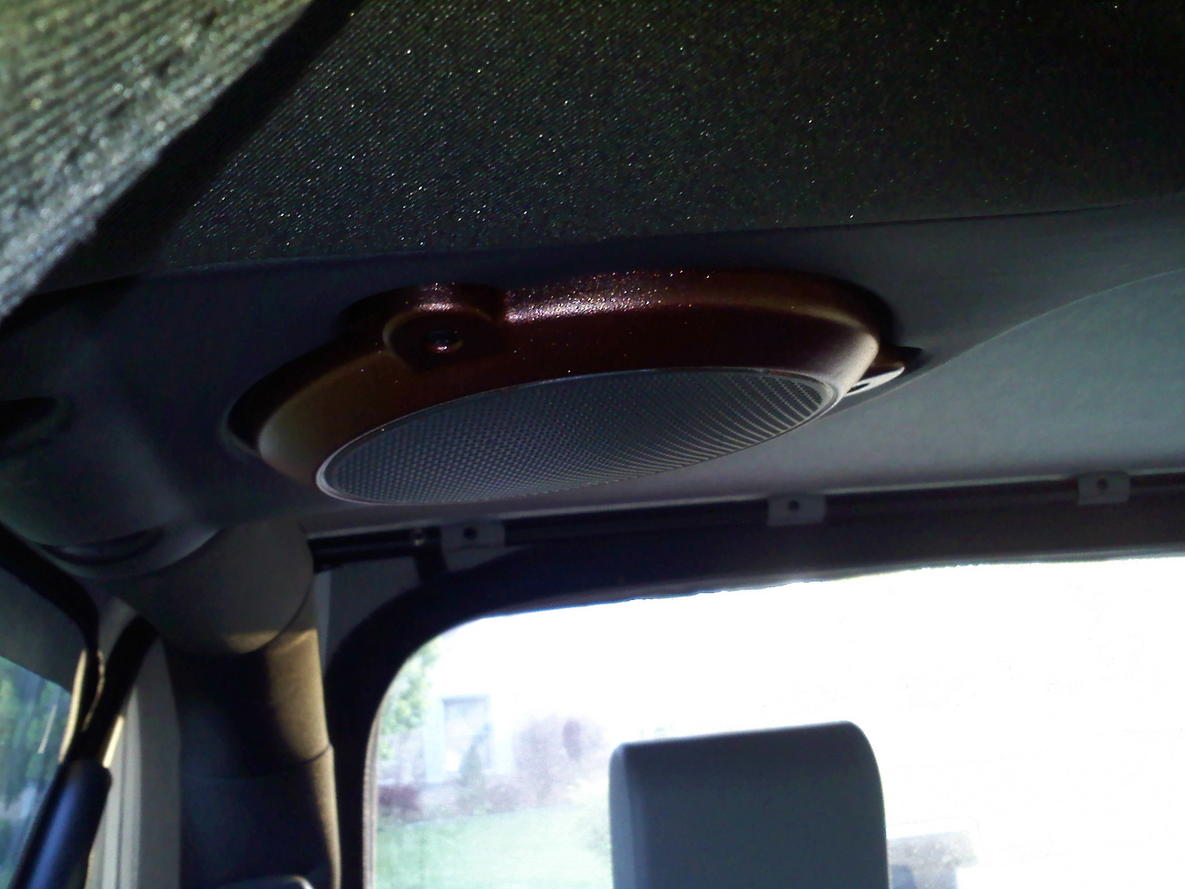

I am a new jeep owner, my first. And not my last.
I did my vents and speakers this past week.
