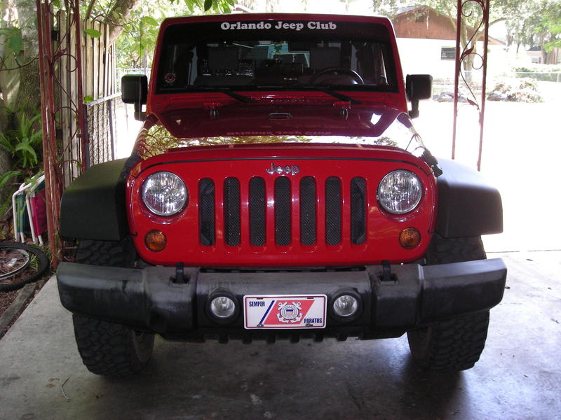

I used my favorite tool. SAW'S ALL . i used 4 L-bracket's frome HOME DEPOT to mount the fog light's. had some left over gutter guard to fill the holes. this will do untill i get my poison spider bumper.

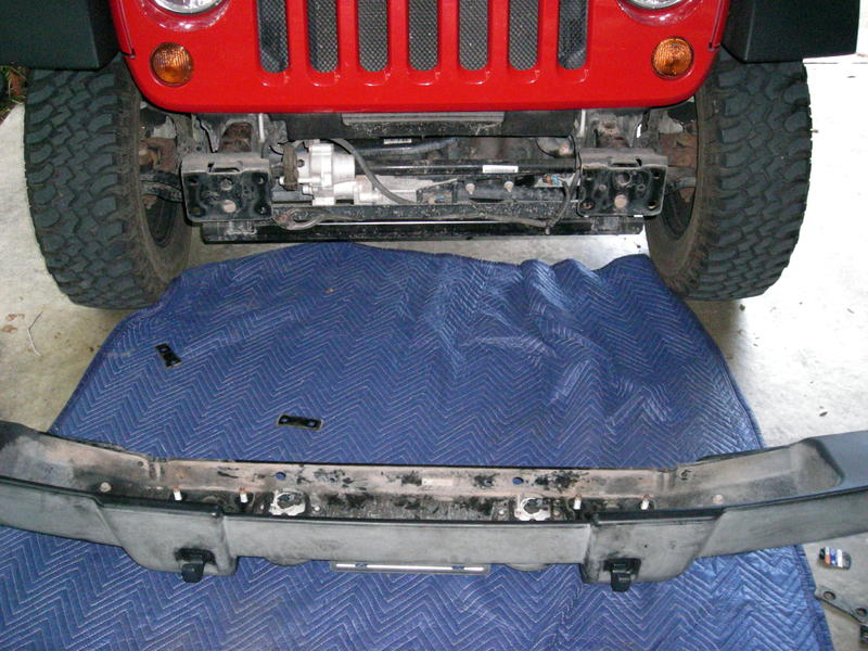

Here's some before shot's. just remove 8 18mm nut's and pull it off. i just couldent stand looking @ that bumper turn white every week with the sun.
