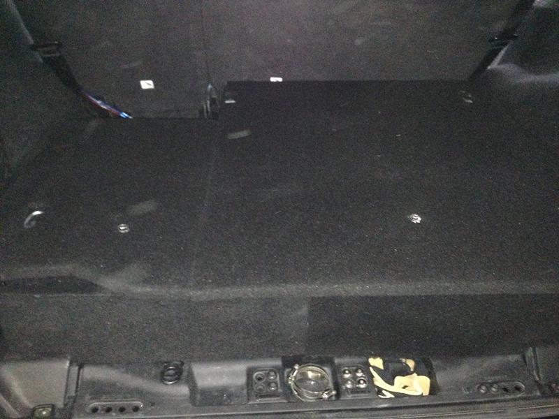

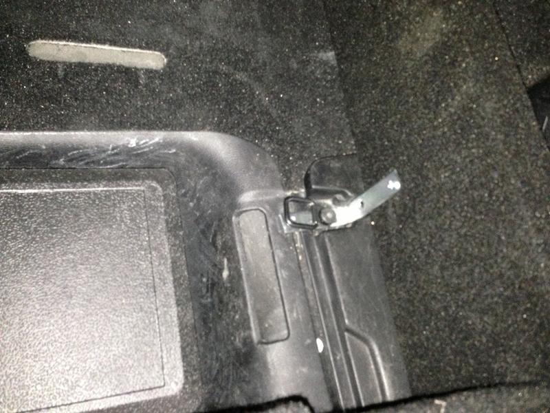

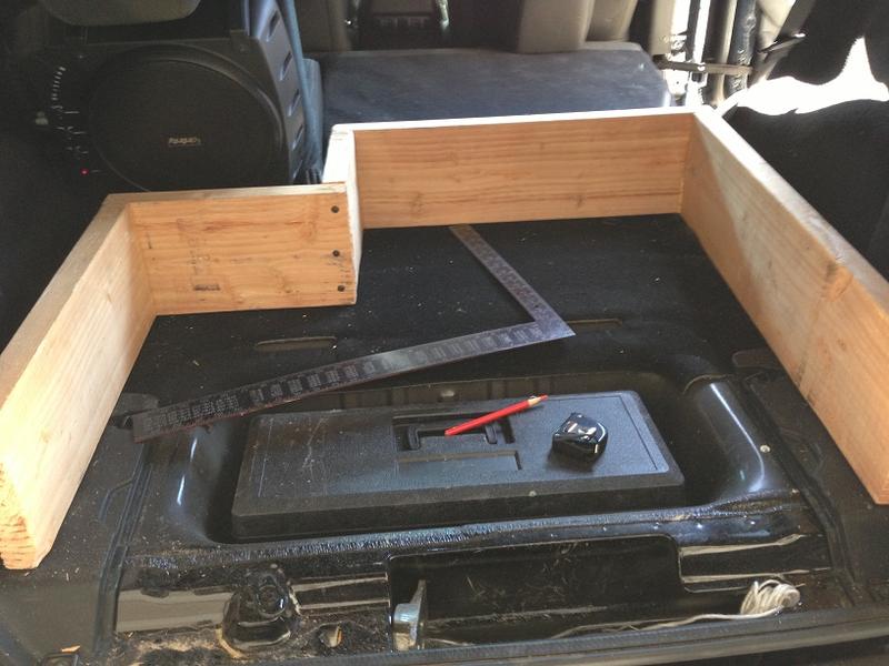

I finally got around to doing this project.
I started with 2x8 but ended up cutting them to 2x6 with the frame built around my Basslink. To still have access to the interior in case the jeep was loaded up, I added 2 doors in front.
The carpet is deep black and doesn't quite match the carpet but might change it later on.
The hooks are bolted to the actual frame so they should hold just fine and the box has a bracket in the back and 2 inside to hold it firm to the floor.
I still have a couple of things that I still need to figure out, but for the most part its good to go.
