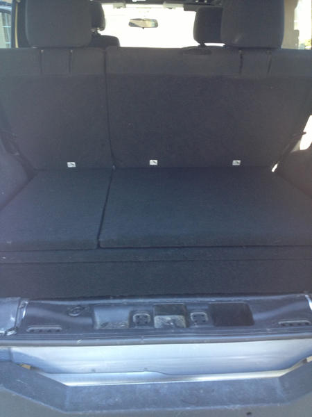

I finally pulled the trigger on this project a Lil different with the newer 11' having all the plastic molding in the back but otherwise came out great. I used a piano hinge set up instead(which I need to paint black)
Has anyone found this lock that the op installed it look like a really clean setup. Now only thing left is to incorporate some tie-down points

Looks nice!
In your send pic, is it a smooth transition on the right side where the seat folds? Can't tell from the angle and lighting.
Where do you plan to mount the tie-downs?

Yeah it folds great with no interference I cut the plywood a hair shy on both pieces to accommodate the thickness of the carpet. As far as the tie downs go I'm still trying to come up with ideas I would like to be able to tie the heavy stuff down in either position I'm trying to find something that can recess into the wood enough it will remain flush when not needed.

You want to avoid mounting the tie-downs to the wood. The cover just isn't secure enough to hold objects in a crash.
This is what I did. I made the tie-downs, but they are available commercially, as well; just a little different design.
https://www.jk-forum.com/forums/jk-write-ups-39/homemade-removable-tie-downs-179999/
