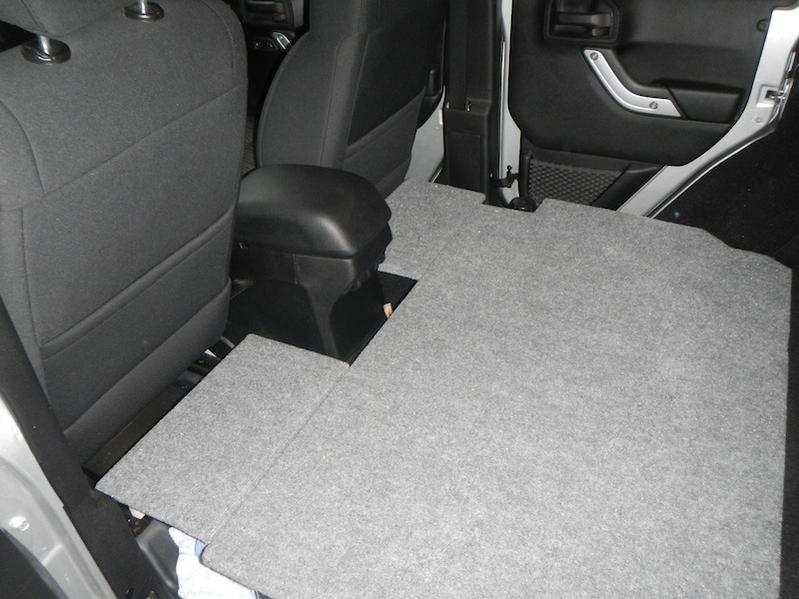

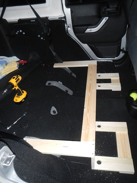

I posted this to another part of the forum, but since I was following this thread figured I'd share my build too:
In preparation for an extended trip out to the Colorado area (and would be MOAB, except for that dogs aren't allowed, but I digress...), I've been in the process of planning and assembling an overland build.
With overland features in mind, an essential feature was to have more water carrying capacity, minimally altering GVWR and also making a more functional storage space. In the end, I also wanted the option to sleep in the jeep, for two, plus dog if need be. Not likely to be the primary sleeping arrangement, but it could be convenient and easy enough to do.
Attached are some photos of my build:
rear seat removed, brackets for FrontRunner 10 gallon footwell tank
brackets now w/ extensions to back for platform
platform in place, with optional to extend to rear seats for more headroom if sleeping
platform demonstrated near flush with back cargo area
option to flip up to access 10 gallon footwell tank in event it needs to be removed, drained, or tilted
For purpose of sleeping quarters, under carpet I placed a layer of thin insulation with has an aluminum feature to help reflect heat since the floor of the jeep could get awfully cold in cold weather and/or wind.
By removing the rear seat I estimate I easily removed ~50 lbs. Using a bathroom scale the seats weighed 80 lbs, but that seems a bit high. The platform I built weighs about ~30 lbs, water storage unit is about ~8 lbs and then 10 gallons of water is roughly ~80 lbs, so not a bad option for gaining 10 gallons of water capacity.
