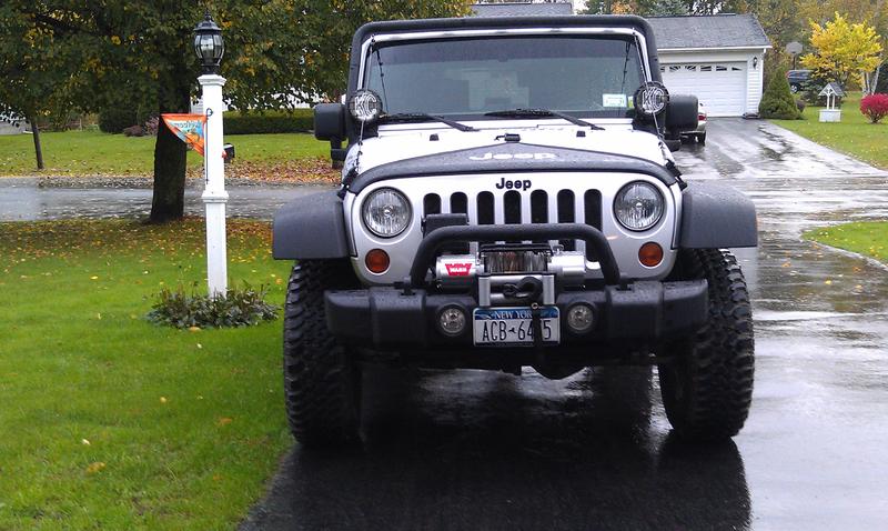

It is still available in my area of west TN. I bought one a couple of days ago. Not sure if they are going to keep stocking it, because the store I was at had them on clearance for $19.99. While I was there, I also bought there 9000lb winch for $249.99 with their coupon. Now I'm working on installing the winch into the stock bumper.
Thats the plate i used work great and you cant beat the price! with the factory bumper i cut with grinder 1" by 4" off of the front corners stack 3 washer under plate per bolt in the front then it sits nice and flat with the frame.Click image for larger version

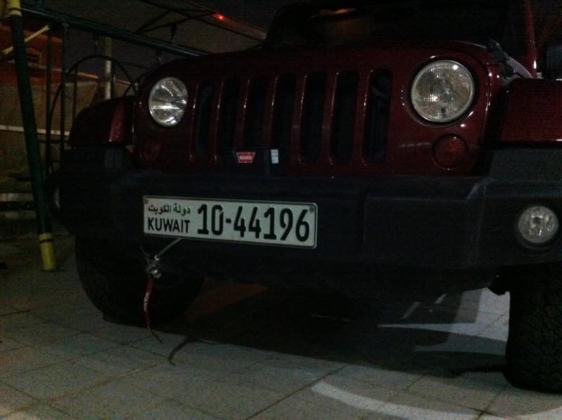

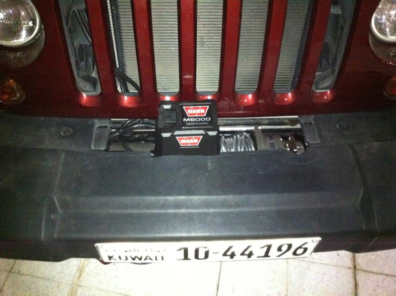

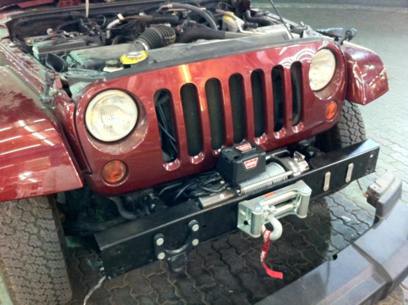

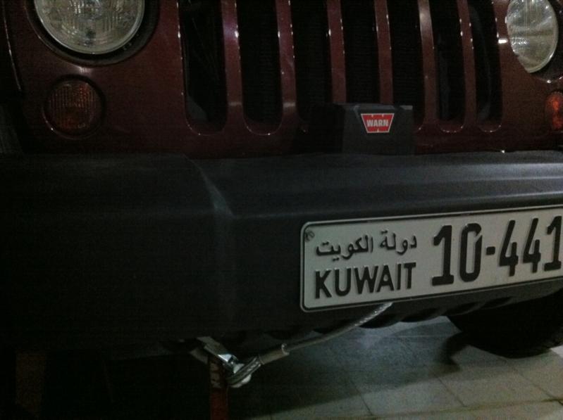

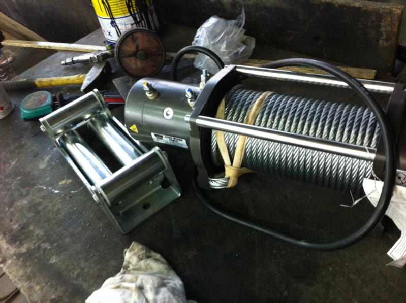

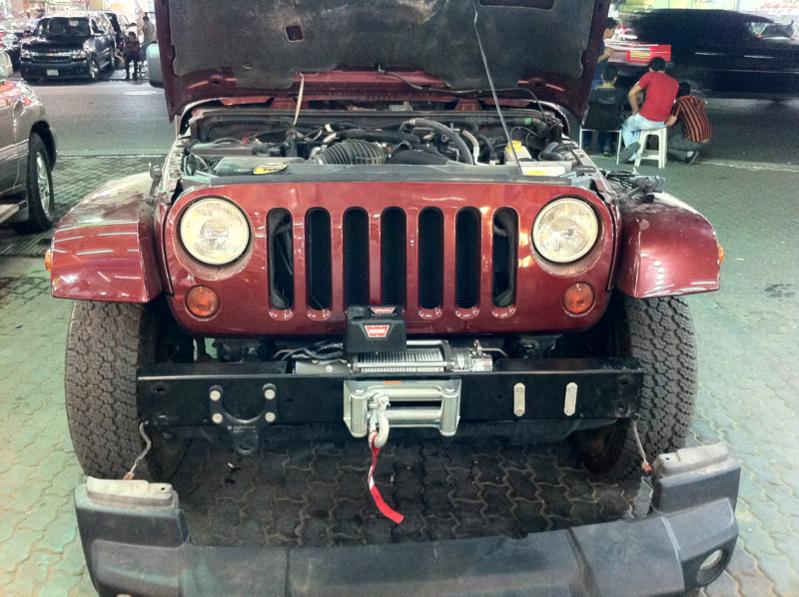

Custom winch mount on UK front bumper
ID:	223826   Click image for larger version
ID:	223827   Click image for larger version
ID:	223828   Click image for larger version
ID:	223829   Click image for larger version
ID:	223831   Click image for larger version
ID:	223832   Click image for larger version

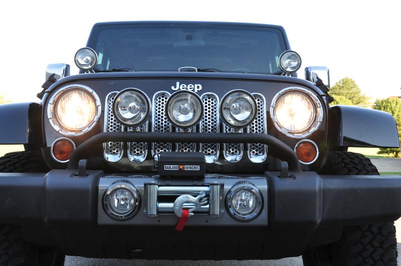

I finished installing my winch into the stock bumper.

Hey, I see the fairlead is screwed on to the bumper. What is it secured to? Do you use a spacer between the metal and plastic bumper, with a longer screw? That part I'm concerned with in case I am winching out at an acute angle, lots of pressure on the side of the fairlead and therefore stress on the screw/spacer...
Thanks.
There is a short spacer between the winch plate and the metal part of the bumper and a longer spacer between the metal part of the bumper and fairlead. The short spacer is welded to the winch plate and the other spacer is sandwiched between the metal part of the bumper and fairlead. I did have to go to longer bolts, but I went to 1/2 size bolts instead of the 3/8 bolts that the plate was pre-drilled for. I did try it out by hooking to winch to my GMC truck and it did great just pulling the Jeep up the driveway, but I haven't had a chance to use it otherwise.
I will admit that I do have a little concern in case I have to pull from very much of an angle. I don't do a lot of hard wheeling off road and I will be using my winch for mostly doing work on some property that I have in the Ozarks.
