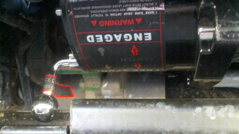

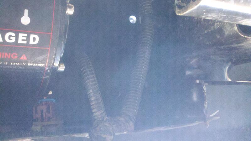

Well finally got the winch in. Still need to do some cosmetics where the flairhead sit, and mount the front license plate with a hinge here is a pic of how tight it is. Disconnected the sway bar, and reconnected it, so doesn't look like any interference with operation. But will have to test it offroad.

Ill post better pics when I get a chance, but basic install is same as everyone else did. Lower part of metal bumper needs to be trimmed to be able to get you hand and ratchet in to be able to bolt the metal bumper back on. If you plan on keeping factory air dam, make sure not to cut off mounting holes. Also since the front tow hooks go through the plastic bumper, its actually easier to remove the 8 nuts to tow hooks and remove the whole bumper from the jeep. Then once it is off remove the 4 bolts that hold the plastic bumper to the metal bumper. But first disconnect the fog lights, and with needle nose pliers pull the tabs out if the metal bumper that hold the wire in place
Old Nov 8, 2011 | 01:34 PM
  #256
RubiTom's Avatar
Posts: 13
From: Stevenson Ranch,Ca.
But to answer everyone's question whether or not this can be done with the Rubicon. Yes it can. I did mine with a smittybilt 8. Anything bigger may be too tight. I'll also post measurements later
