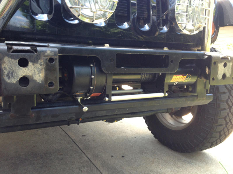

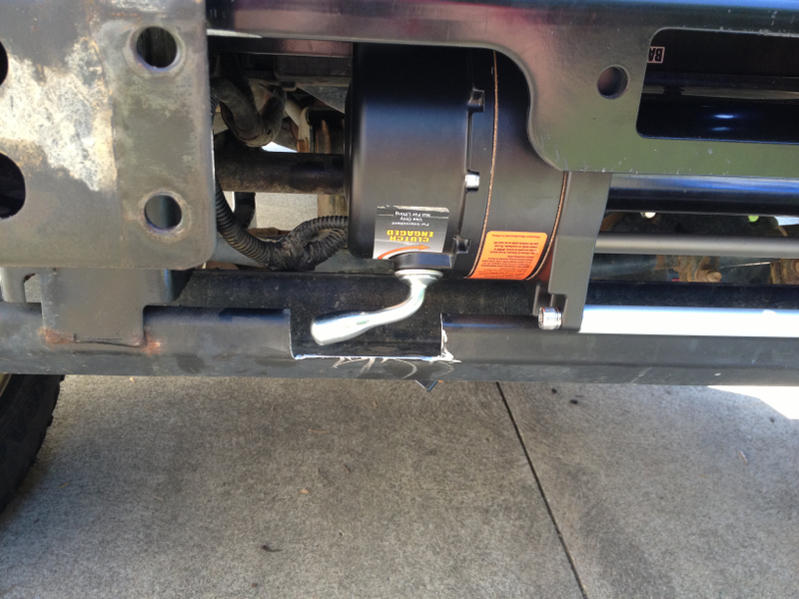

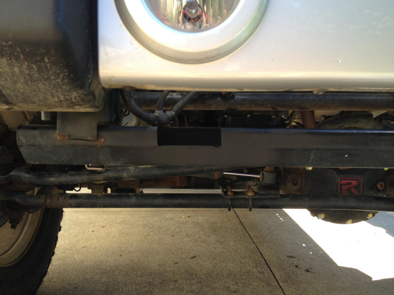

Progress made so far. Quadratec Q9000S winch with synthetic line. Harbor freight universal plate.

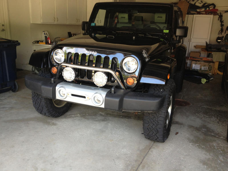

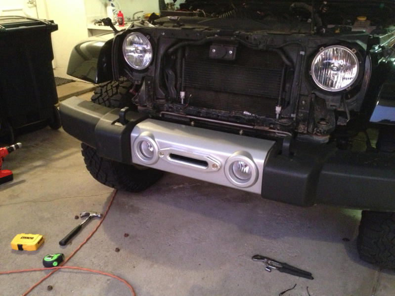

Still need to add fairlead spacers to support the innards of the bumper, mount and wire the solenoid and wire up my switch

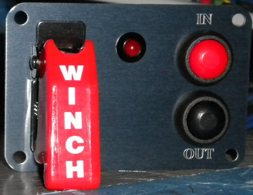

Where'd you get that switch
