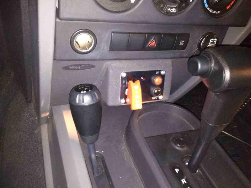

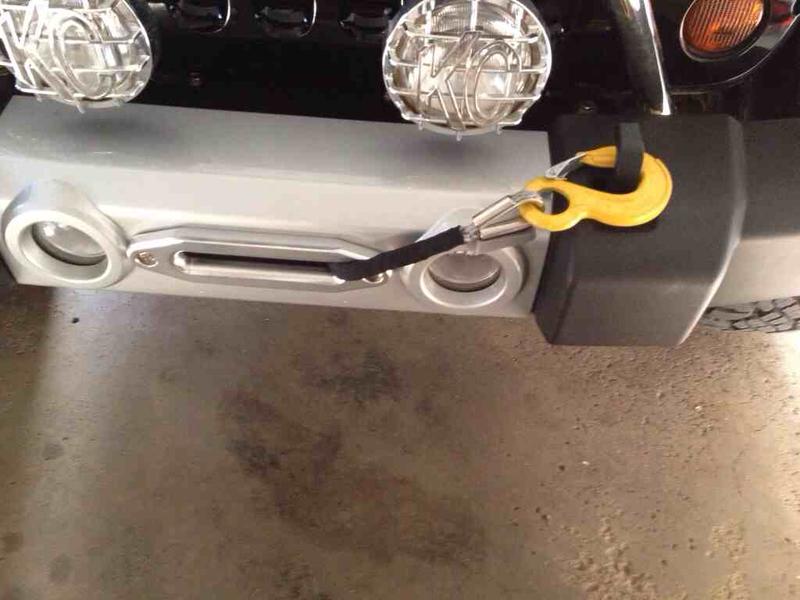

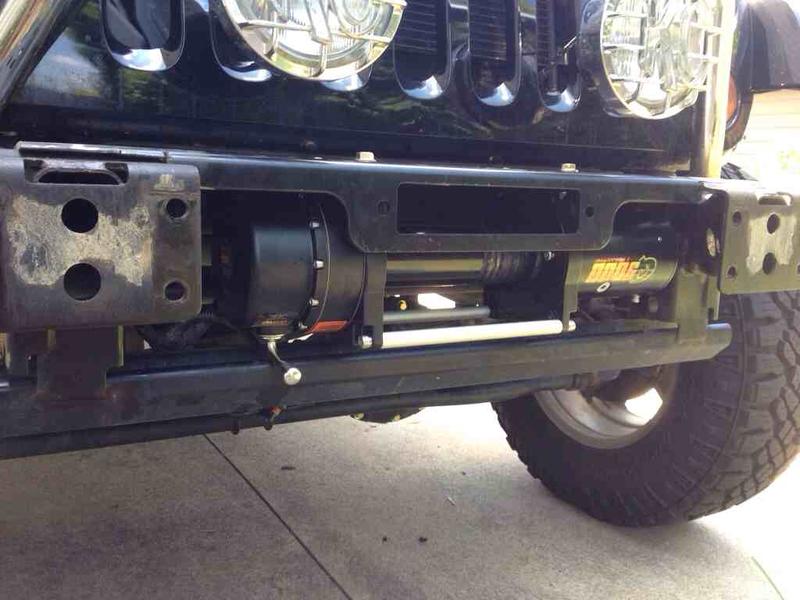

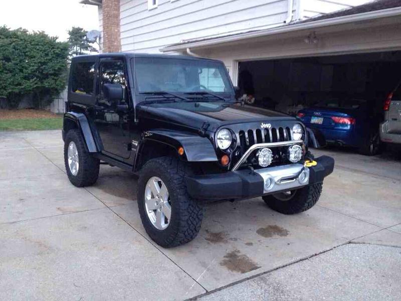

Just thought I'd post mine up again

Originally Posted by AirJordan613
Almost done! The rest of the work is under the hood!
What mount is that for the in cab controls? I hate my blank panel and that looks awesome!
Old Nov 24, 2013 | 04:48 PM
  #409
AirJordan613's Avatar
Posts: 1,389
From: Cleveland, Ohio
It is the rugged ridge lower dash panel. Daystar makes one as well and it's much more popular but I liked the look of the rugged ridge better.
