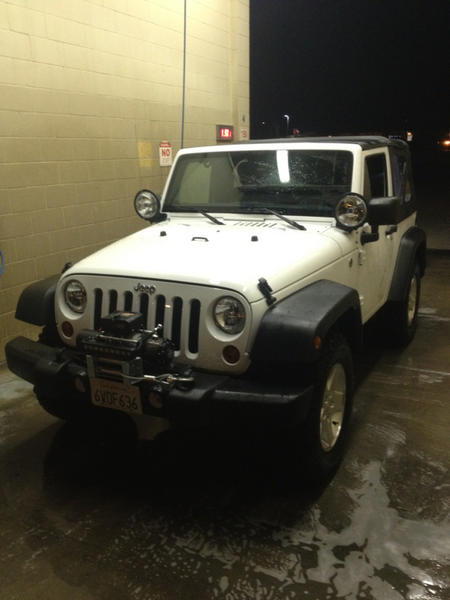

My 12' with xrc 10 Smittybilt.

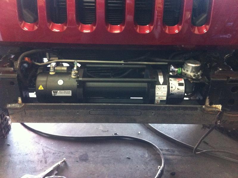

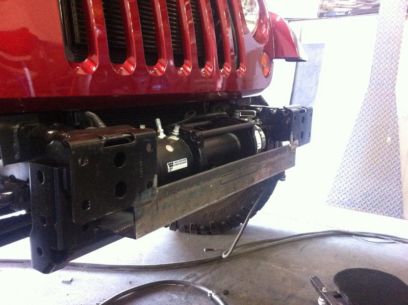

ID:	319347So he didn't get to finish today, but hope fully first thing in morning! so as i promised, here are a few snap shots I got with the iphone.Click image for larger version

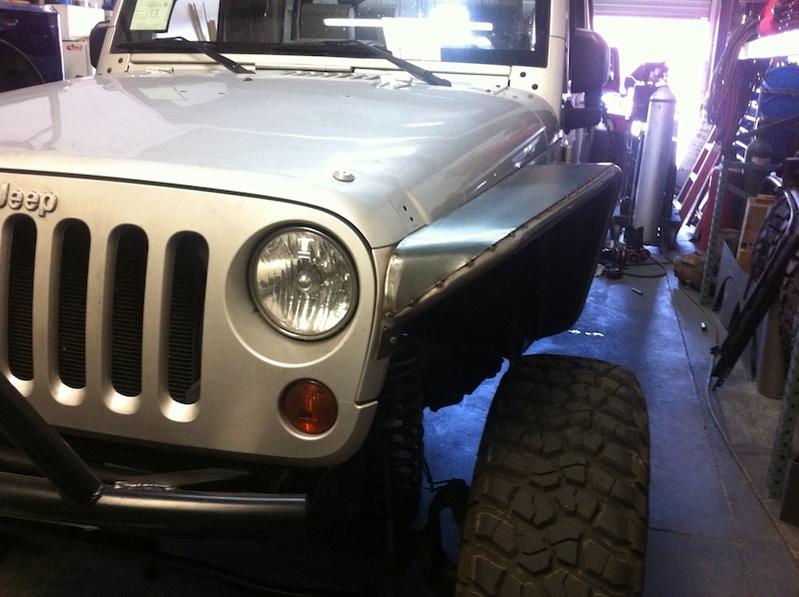

Originally Posted by Jsboening
Thanks for the post. It's looking great!
Thanks! Not much more to go now. Just need to cut the hole for the fairlead and plastic bumper cover. Make sure everything matches up, get it wired and spooled and put the plastic pieces back on!
Here are a few shots of projects he's got going!Attachment 319370Attachment 319371Attachment 319372
The tires are 44"...whoa! They are for the purple jeep.
The purple jeep is having extensive work done as you can see. The silver 2010 JK is a 2WD that is being converted to a 4WD. Also, the fenders on the silver jeep was fabed by him, as well as the bumper and stinger.
The other jeep is rhino coated with a custom bumper by him also!

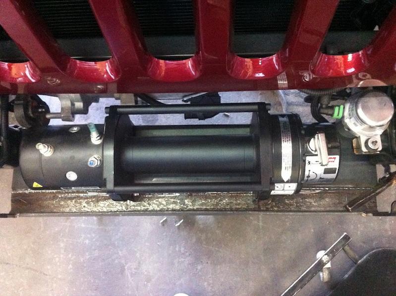

One more shot from the top. As you can see, the disco motor is well out of the way. It only looks close because of the angle. I got a good look at it all around and there's a good 1" to 2' clearance in all directions. From what I gather, it looks like he welded the plate lower, so that its sitting on the crossbar (see previous picture). We also fitted the winch on the plate with the plastic cover on top to get an idea about the fit, to make sure it wouldn't stick up above the bumper and it was a perfect fit with room to spare!Click image for larger version
