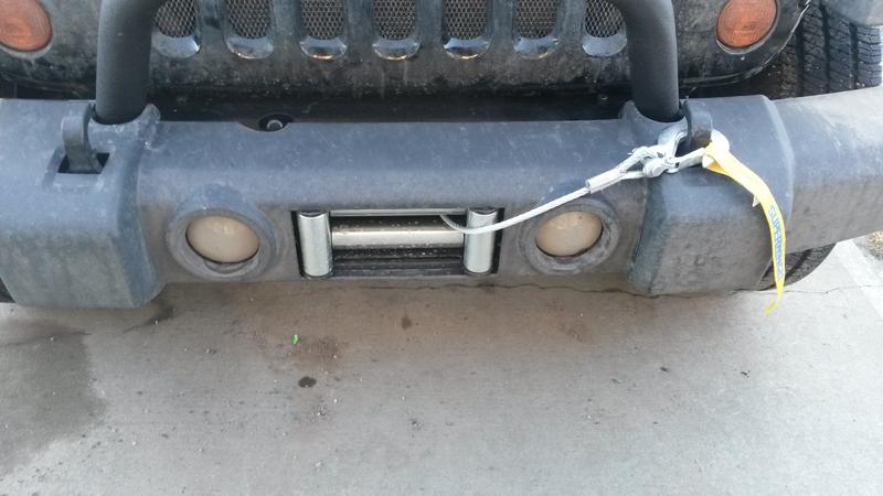

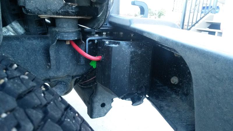

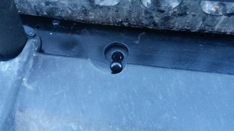

here's my shot at it, it's mounted upside down but i rotated the drum so the lever is still on top. I mounted the plate so the fairlead roller was about 1-1/8" aft of the frame ends. the sol box is outboard of the frame on the passenger side, i would have taken pics during the whole process but it was about 25* below and ain't nobody got time for that! i had to relocate that damn vacuum pump so its just hanging out in my engine bay right now, but i will mount it to the OBA bracket when i start that project. I snipped a bit of the frame ends off so that i could get a wrench in there, and then elec taped the washers and nuts together on the end of the wrench, thanks OP and all other contributors for the inspiration and how-to to do this, if anybody has any questions about my take on it, hit me up.

i love the factory bumper look with the winch attached but i have to ask you guys that already installed it how did you get the bolt/nut to stay and how did you hold it in that tiny cavity

I drilled mine completely through the frame and put the nut on the bottom

there were two bolts holding the two ends of the winch together, i undid those and pulled the end opposite the motor off the "axel", on it's face there were about ten allan bolts to remove then just rotated it 180, and put it back together, it only took me a bout 5 minutes, but other winches may not be ably to do this. I used a superwinch lp8500.
