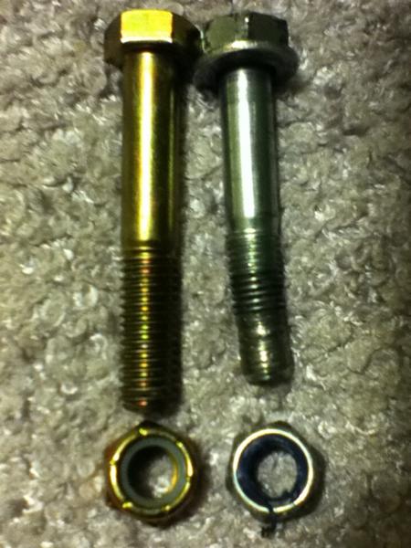

Going to buy bots today..already out running..anyone know the the bolt size for the UCA's ? I know it is MM but I need the dia. And length ... Thanks
I know its a Grade 8 Metric with a 21mm head. It'd be the metric equivalent of an SAE 9/16", 4" long.
Did the 1/2 have a shoulder ( no threads towards the head) or was the entire length threaded ?

Originally Posted by PainKiller
...Front upper
The size of the bolt is the same for all 4 control arms I thought. 21mm 4" long or 9/16" SAE 4" long.
It has a shoulder. Threading on about 1 1/4" or so of the bolt.

And for reference, here's the picture I'd posted a few days back of the bolt:
