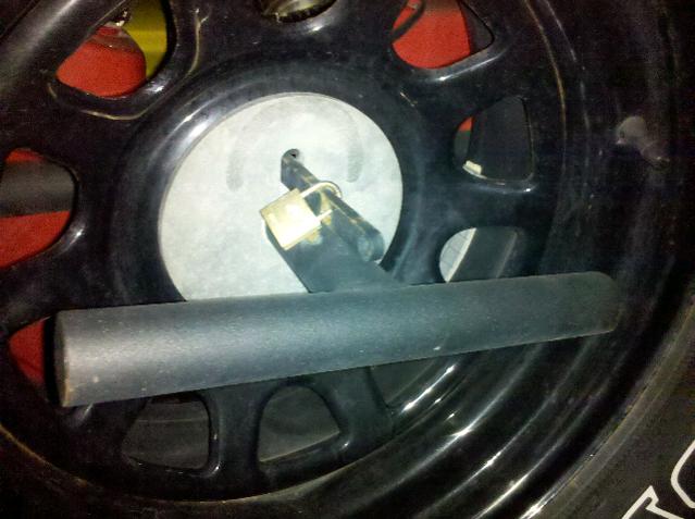

The only pic I have at the moment of the tire carrier's t-bar is this one:
If you want a certain angle or straight up, I can go out and take a couple of pics for you.
Thanks
See a couple of posts up for my progress
So... from looking at your pic, and reading around, it looks like the t-bar itself doesn't "pull" the tire in? What is actually securing the tire?
Sorry, for all the dumb questions... this things gotten the better of me

...So... from looking at your pic, and reading around, it looks like the t-bar itself doesn't "pull" the tire in? What is actually securing the tire? ...
There's never any dumb questions bud , but there are plenty of dumb answers and I'll try not to give any of those
Ok, on the t-bar, it kinda "threads on - so to speak. You should have a round metal plate and a thin long piece of metal - the thin long piece of metal is what you can lock the tire in with, and it kinda screws in there. I'll try to go out and see if I can take a couple of quick pictures for you. Also, that bar is what you'll rest your spare tire wheel on when you get it up there. Then, you stick the plate and start threading the t-bar in and it'll eventually press the plate tight against the wheel and keep it there - trust me, it won't budge. Make sure you put some anti-seize on that - last thing you want is the thing seizing up down the line when you need the spare

Here's a couple of pics I just took. Let me know if that helps.
thank, those look good
So, I think I see how it all connects, but wouldn't the tire just slip back until that metal plates hits your lock?

Originally Posted by jwhitehorn
...but wouldn't the tire just slip back until that metal plates hits your lock?
Nope, the t-bar threads on, and the spare tire wheel rests against the back of the carrier, and the plate presses it on to keep it there. The lip of the t-bar (looks like a threaded pipe) is larger than the opening on the round plate - so the plate can't slide out over the t-bar. Only way to get the plate out, is to unthread the t-bar - if that makes sense.
