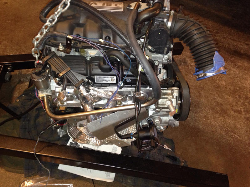

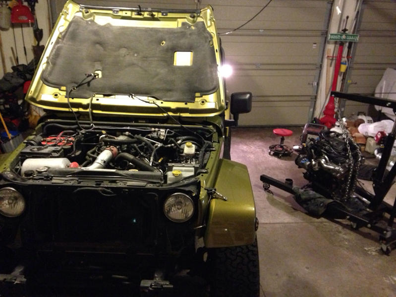

Picked up my new 3.8 engine this morning. Turns out it only has just Over 50 miles on it. Turns out he drove off the Jeep lot and immediately began the LS transplant.
You can see his modified Jeep in the background (see exhaust tips).

So basically a brand new engine. Thats awesome!

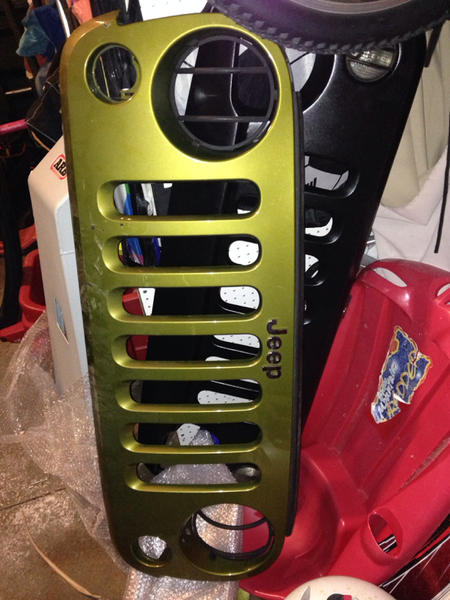

Anybody need a Rescue Green grille? I'll be replacing mine.

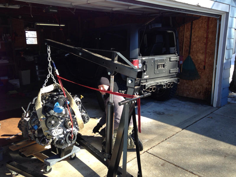

I spent a few hours today in disassembly mode. There's just no easy way to do this job. I'm down to the last few bolts and have come to the realization that I can't reach the top bolts that connect the engine and tranny. Damn! It looks like I need to pull the tranny with the engine. The Jeep shop manual should state in the engine removal section: 'don't freakin kid yourself, even your wife's forearms aren't small enough to reach the back bolts.'
I even removed the fender liners to see if that would help - nope. Removing the body would be the way to go for sure. Unfortunately, I don't have a hoist.

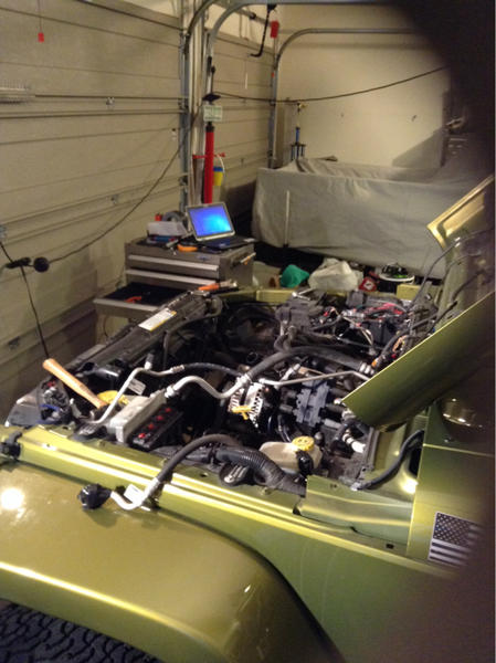

If you have ever wondered about the cracked factory exhaust manifolds: here's whAt it looks like. This is the drivers side and it is cracked just about all the way around.
Still working to get the damn engine out. :-)
