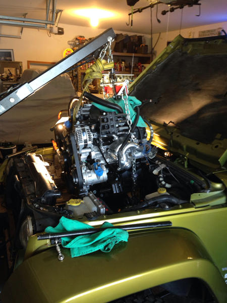

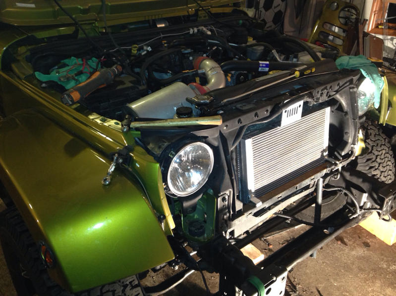

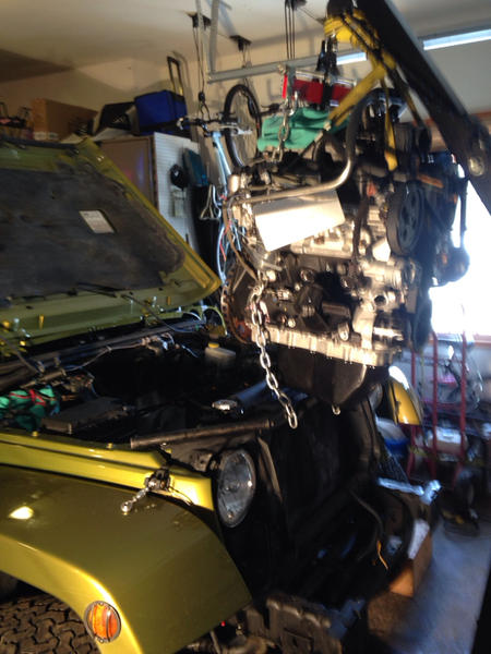

A few progress pics. Reassembly begins! Click image for larger version
ID:	534600 Click image for larger version
ID:	534601 Click image for larger version
ID:	534602. If you are a weekend mechanic wannabe, don't expect you can get this done in a weekend. Lots of little issues that mechanics probably know just what to do. For me, they took forever as I over analyzed options. After a weekend, the engine is in the engine bay but not connected to the tranny yet. I was also working alone. I would imagine a second set of hands would have also sped things up. Ended up working on it for a couple hours Monday night and the engine is now mated to the tranny. Now it's time for reinstalling the accessories, wiring, y pipe, grille, front bumper/winch and then a test drive. I hope all that happens over the next couple nights after work. If all goes perfect (ha!), the supercharger gets installed Saturday.

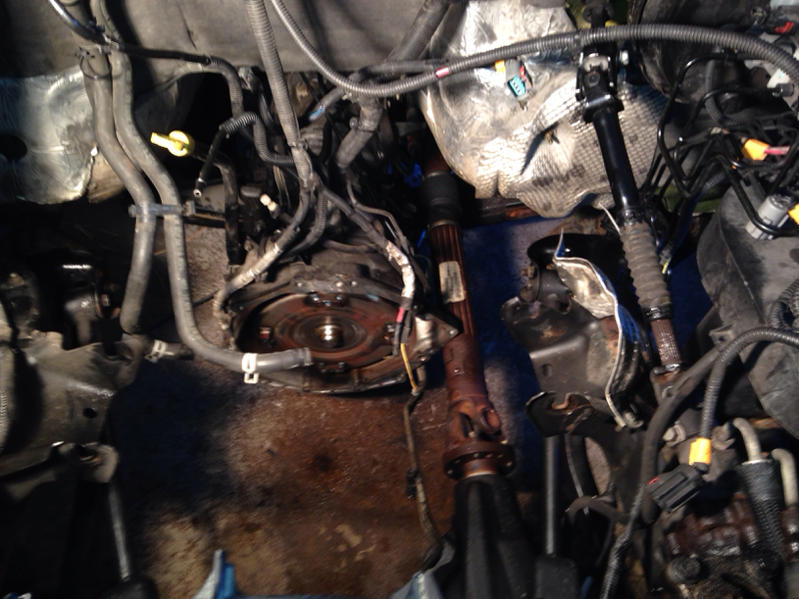

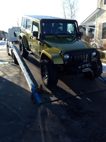

Back at it this weekend. The 2011 engine is in the jeep and everything is ready to roll with the exception of the darn starter. Click image for larger version
ID:	535859 Starter is installed but it won't start. I think it may have vapor lock in the fuel line. Called local garage and they came and took it. started installing the AEV Magnuson supercharger components (hoses, intercooler, etc). The main components won't be installed until after I put some miles on the new engine. Reassembled most everything including the new angry hog grille. Click image for larger version

Old Mar 11, 2014 | 03:06 PM
  #47
46chevytruck's Avatar
Posts: 420
From: Oconomococ, WI

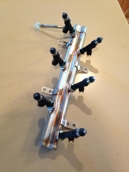

So the initial diagnostics came back on the jeep today. Bad gas that sat in the injectors and fuel rail for over 1.5 yrs created a varnish in the fuel rail and fuel injectors making them stick. Previous owner did not run the fuel out of the engine before removing it. Even though the engine only has 53 miles, the fuel injectors are all gummed up and need to be replaced! If you buy an engine make absolute sure it was run dry of gas before settling on a price. If it wasn't, take that into consideration on your purchase price.
New prices to replace these components is $82.60 per fuel injector x 6 = $495.6 + new fuel rail $148 = a grand total of $643.60 in parts because of 1.5 year old fuel left in the engine.
I'm fortunate in that I can use to original fuel rail and my injectors will be replaced with the supercharger but I no longer have $643 in parts that I can sell on the used market (albeit only getting half of that if lucky - but it is still about $300 that won't be in my pocket)!
Hope to have it back running later this week. Stay tuned....

The 2011 is officially installed in my 2007 JKU. It is running with no warning lights on the dash! The fuel rail was replaced due to old gas varnishing it up pretty bad. It is all gummed up (but looks brand new - because it is). I'll be cleaning the entire unit. The Magnuson AEV Supercharger will be installed next week. Click image for larger version
The Gibson headers make the exhaust slightly louder. Not sure about performance yet. I'll run a comparative 0-60mph test this weekend.

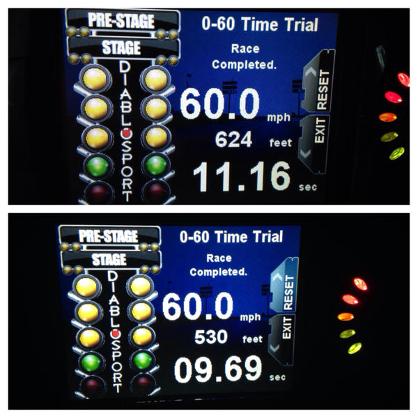

Originally Posted by 46chevytruck
<img src="https://www.jk-forum.com/forums/attachment.php?attachmentid=532483"/> Baseline 0-60mph time with DiabloSport 91 tune with 35" tires. The was the best of three attempts. This is before the SC install.
Here's the new 0-60 time with the newly installed 2011 3.8L, with Gibson headers and the 2011 y pipe. Both times had cat back exhaust and the DiabloSport 91 tune. Top time is 2007 3.8L with 112,000 miles and cracked stock exhaust manifolds. Both times were done with the DiabloSport drag tree motion start function. Both are best of three attempts on the same road. Click image for larger version
ID:	537239 Not a bad drop in time. Can't wait to see what the AEV supercharger will do.

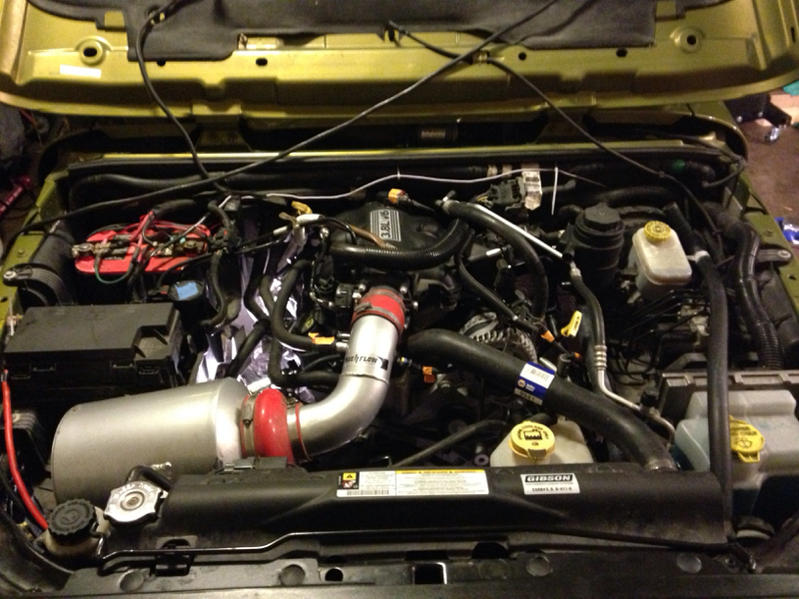

About 2pm today I decided to install the AEV Magnusun Supercharger. I finished at about 11:15 PM. Great instructions and found an install video on YouTube. I had the intercooler installed already (did that when I swapped engines). Instructions state 8-10 hours. Don't kid yourself, that is a full weekend job for most. Not hard, just time consuming. I still need to reinstall inner fenders and some mini things but overall it's in and running. Test run tomorrow. Before: Click image for larger version
ID:	537839 After: Click image for larger version
