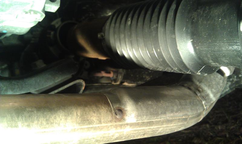

Originally Posted by Blade
Is this full droop on a lift or on the groud during full articulation? Reason I ask is becaus I still had this much room with a factory shaft at full flex:
Attachment 274745
That little bit of clearance is after installing the aftermarket driveshaft, at full droop on a lift, and with the swaybar still connected.
I'm guessing that you still have plenty of clearance because you aren't running longer shocks that provide more flex.
