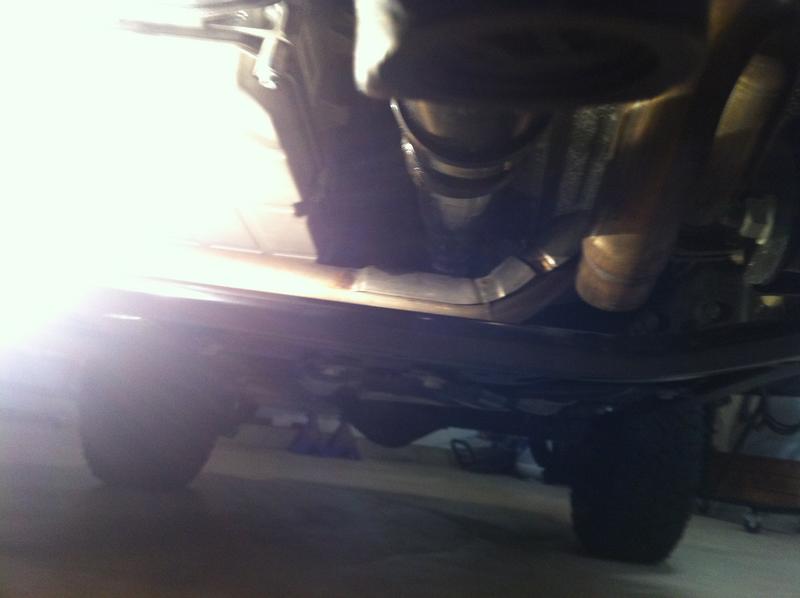

Here's full drop.... It's tight.
Beautiful!

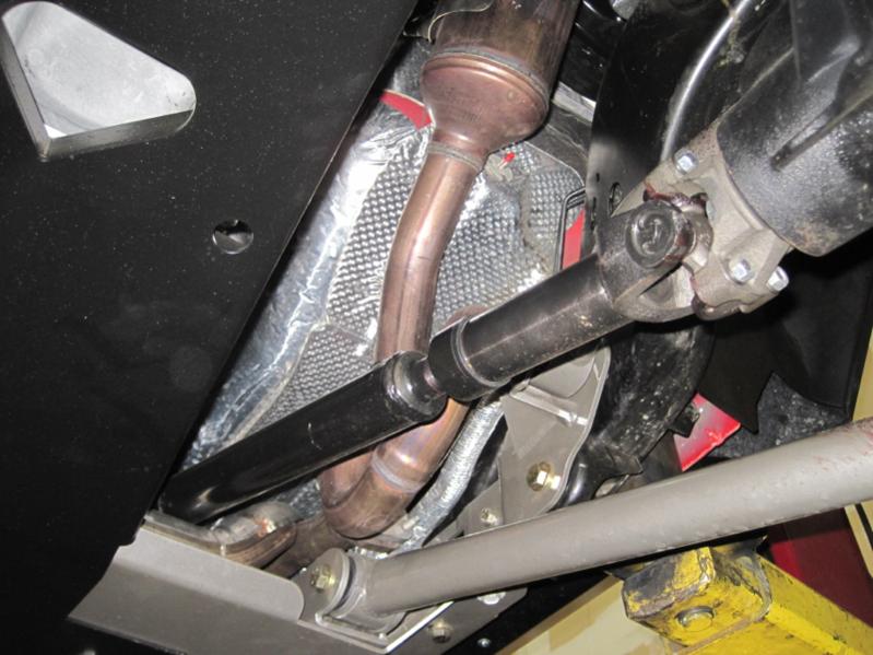

It is. I even took the heat shield off mine, just for peace of mind.
But the 3" FT lift and 1310 JE Reel combo works great.
Here's a pic of mine still on the lift at full droop, before everything was torqued to spec, caster adjusted, etc. Got a little more clearance after that.

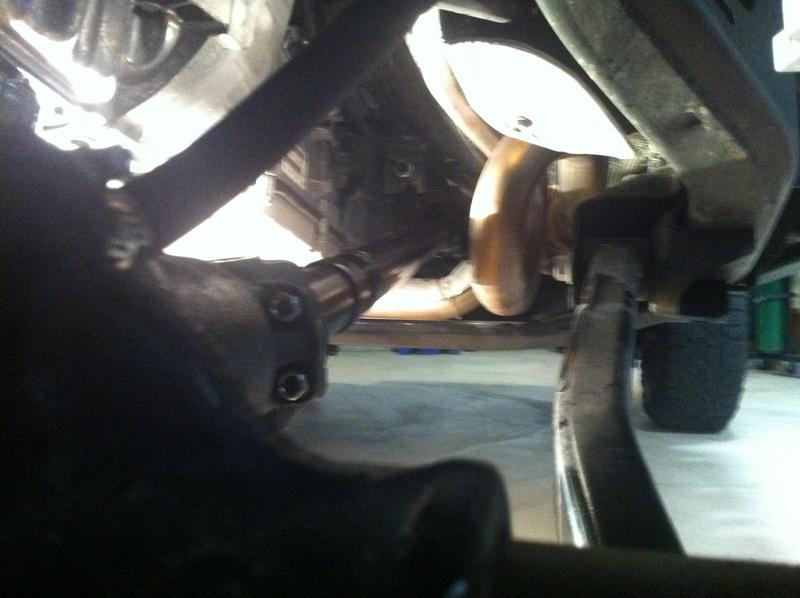

I installed the new Coast drive shaft and this has given me plenty of clearance now. Since the new shaft is about 1 1/2" smaller in diameter and the pivot point is extended further from the xfer case this now gives me an inch or inch and a half clearance at full droop. Perfect!
ID:	274497Click image for larger version
