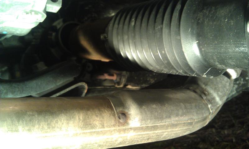

Originally Posted by bo9roadking
After getting my RK 3.5" lift installed a few months ago, I had to install a new Coast 1310 driveshaft. In this photo, you can see that I had maybe 1/4" clearance above the stock crossover at full droop. I wasn't comfortable with that little clearance, so I also installed the y-pipe.
Attachment 274726
Is this full droop on a lift or on the groud during full articulation? Reason I ask is becaus I still had this much room with a factory shaft at full flex:
