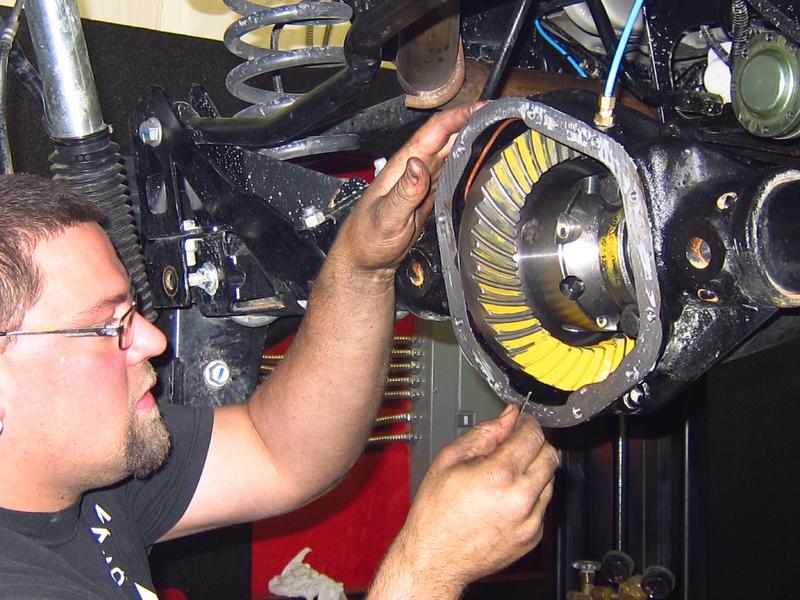

I have 4:88s and am spinning a hair over 3,000 at 75mph. If I was planning on a true 37 (38) I would have gone 5:13s. It's a big difference coming from 3:21s, but if I had 3:73s or 4:10s I might have been hard pressed to switch with anything under 37s. The ECO light is almost always on now and and idling/rolling speed is much faster. I can idle in and out of parking spots now, where I used to have to give it some gas when the wheels were turned. In 4LOW I can idle over logs 6-8" tall (haven' tried bigger, but likely need to tap the gas). If you have an auto, the new trans does a great job managing things so the difference probably is not as apparent as with pre-'12 autos. I also was getting a locker put in so I figured while we were at it.....
