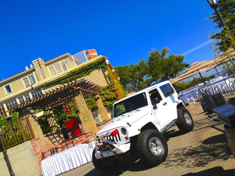

This is 2.5" AEV on 34's....

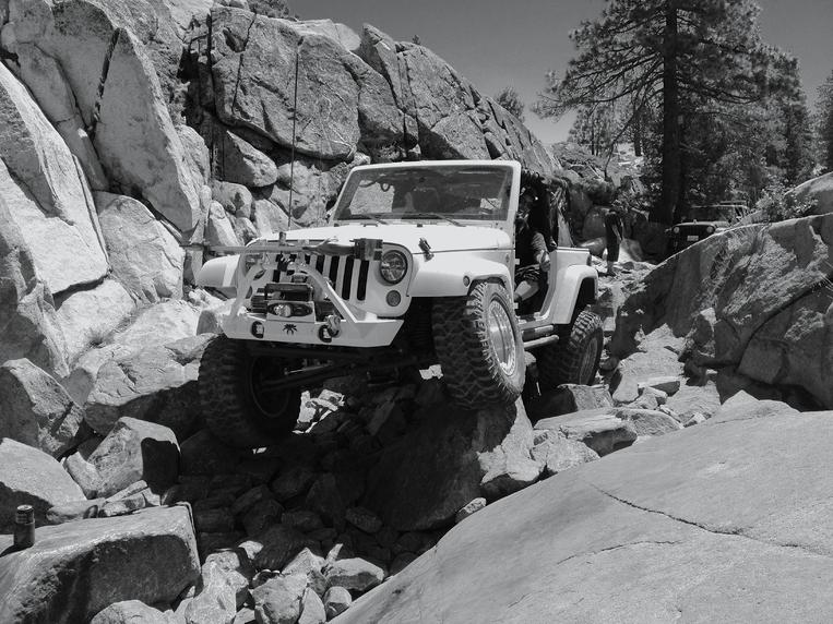

If you're hitting the big rocks like the pictures I've got posted and you find yourself doing those trails more often, you'll eventually want to ditch the correction brackets and go with legit set of control arms. There are a lot more options with now the longer fixed length control arms and the adjustables. For example, I'm using the JKS J-Axis on mine...
...but if you're not, you'll be fine with just the correction brackets. They're so good that pretty much every other manufacturer has copied AEV's design.
