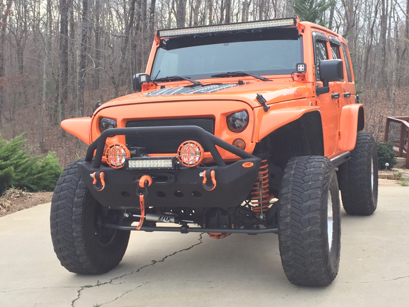

With the wider track of the UD60's what backspace do I need to run to have no rubbing at full lock? Going with 40x13.50 Nittos. Beadlock wheels 9" wide. Steering is all Synergy with a hydro as well. Flat fenders and adjustable arms.
Anything else I need to be aware of? Wondering how many have run a similar setup. Pic for what she looks like today.

How much lift? You want at least 4in of lift and minimum of 3.5in of backspace. You might barely touch your frame at full turn. Pic is when I first installed my UD 60s. 40x1350 toyo mt. 17x8.5 trail ready bl with 3.5 backspace. 4.5in of lift an had to trim a small amount of the front pinch seam an barely touched my frame at full turn
