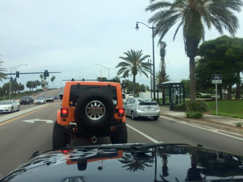

Smittybilt XRC. It works fine for my 37's but not sure about the weight of the beadlocks and the 40's. We'll see...
