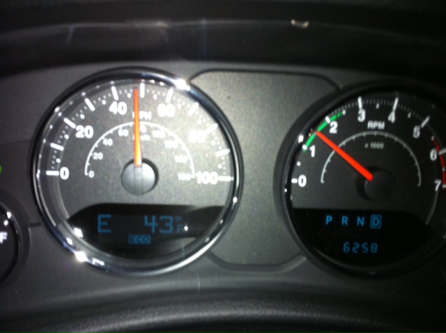

Default It can't do that
is what I'm being told by 1 board member. It doesn't have the power to do that.....you can't do that.
This is on my daily drive to work and it does just fine. No gear hunting at all. It will downshift from time to time but that is what an automatic transmision is designed to do. Shifting is acceptable as long as it is not excessive.
BTW, please take note of the green marking on the tach. You will notice solid green up to about 2K RPM? Above 2000 RPM you will notice that it becomes intermittent. At 2500 RPM it completely goes away.
Ya think that may have something to do with efficiency and fuel economy? Looks to me that it is most efficient BELOW 2200 rpm. What did I say in an earlier thread about the designers wanting to keep RPM around 1900-2200? Oh ya, I did say that, didn't I?

Originally Posted by planman
We are talking about wind drag and about pushing a 5500 lbs JK down the road at 70-75 mph, with cross winds and inclines. The JK doesn't produce enough power to do that at 1600 rpm without gear hunting.
I agree. I NEVER said you could acheive 70+ mph at 1600 rpm though.
Are you able to see what I am talking about regarding torque now?
Oh, ad btw, my speedo has never been recalibrated after putting on the Rubi take offs so you can actually figure out how fast I was going with the speedo reading and difference between the 29" stockers and 31" Rubi take offs.
So you FINALLY admit that your argument only pertains to 50 mph hwy speed fairy land and not real world hwy speeds?!?! Pretty sure you knew you were off-base from the get go. I have a 2 dr. X with 3.73's and tires that measure 30.75" (Rubi take-off BFG's as well) and the stock gears DO NOT CUT THE CHEESE going down the road battling head winds and grade changes. How can you argue that the factory gearing paired with the 3.8 is adequate? It's not. Doesn't work. Plain and simple.
