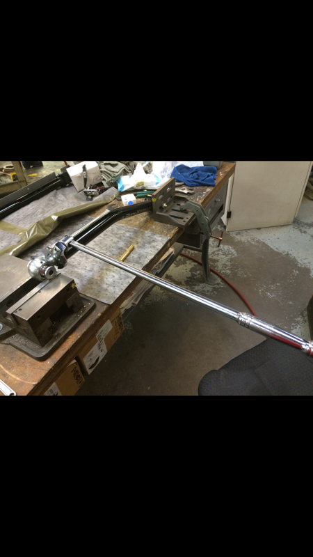

Crows foot and breaker bar
Was that from Goody? The pic looks familiar and I've got a few of these that I've been asked to double-check.
Amazon.com is where I got mine.
