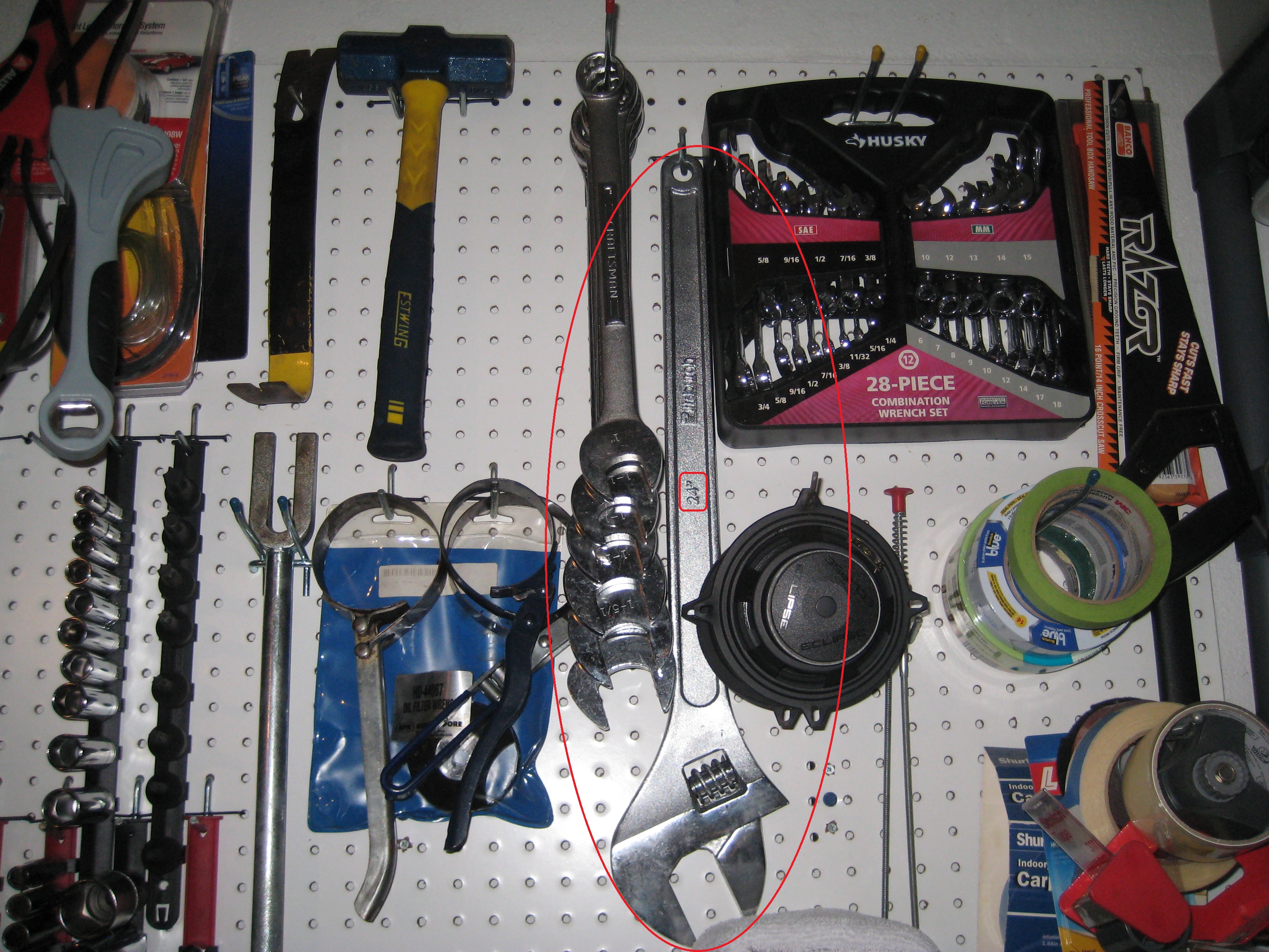

^That's what I use. Never had one come loose yet. The two footer. I've had joints come out though. You buy a Wrangler and all of a sudden you need monster sizes of every tool you already have. It's like having a tractor I would imagine.

Was that from Goody? The pic looks familiar and I've got a few of these that I've been asked to double-check.
No kjeeper haha I got the idea from him.
I don't like using a regular crescent wrench because of the slop. They don't seem to grab the not tight rounding off the edges or slipping.

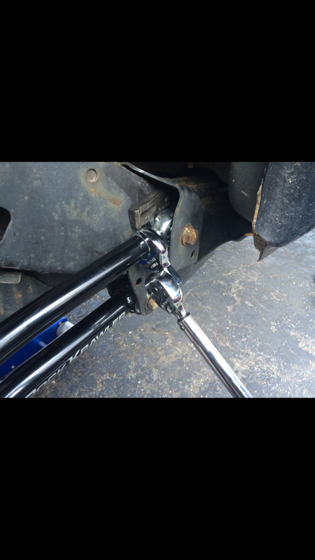

The only arms I tightened on the jeep,
rear uppers. I used pieces of metal to keep the joints centered

Never had that problem even with the cheap HF wrench. Never came loose, never slipped.
Now I'm wondering if I tighten them enough. I don't kill myself on it. Whatever a 180 pound guy at 2 feet comes out to. Maybe 200 lbs. with the extra foot of leverage.
