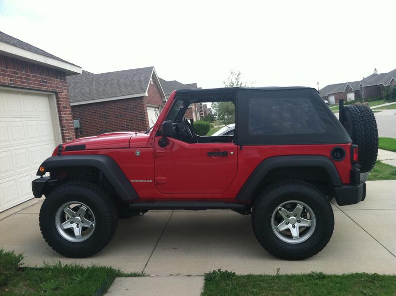

Originally Posted by SH0RTBUS
..... Not really sure why I chose the AEV brackets over other brands. I guess I did so based on good luck with their hood, wheels, and tire carrier. I would just go with the cheapest brackets you can find if going the bracket route. There is nothing special about them.
Attachment 294440
Actually, the last sentence is not entirely true. The AEV brackets do more than just drop the front control arm frame side mounting points, they reposition the upper and lower arms' mounting points relative to each other, and that is how the brackets reduce brake dive and help reduce body roll/lean. It's also what reverses the oem or adjustable arm set up pinion rotation on stuff or droop. Take a look at the brackets on your Jeep, you will see that the upper arm is dropped significantly more than the lower arm (there is some fore and after alteration of mounting relationship also, as I recall) and that is what is "special."
There is another brand of bracket which is a knock off of the AEV bracket, can't recall the brand, but last I looked it cost the same as the AEV bracket.
Brakets that merely drop both upper and lower arms equally add almost nothing, maybe improve ride a bit, and just hand lower.
JPK
