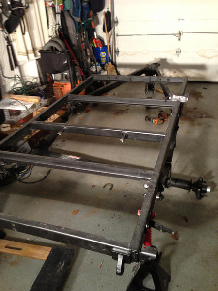

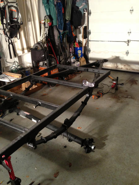

Making progress. Frame stripped down, sand blasted, primed and getting ready to attach new axle. Was able to knock off lower shock mounts from original axle so I can keep original set up. Bed of trailer also sandblasted and primed.

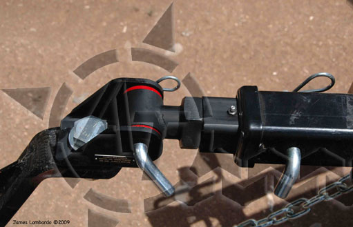

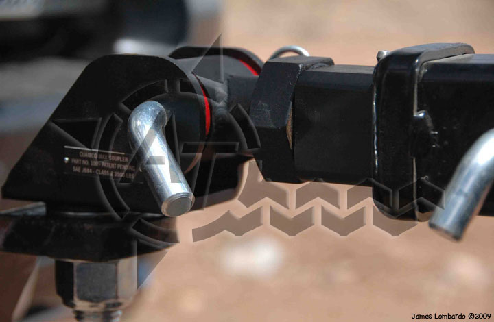

The best coupler for on/off road I have found is this one, rated up to 6,000 lbs! So, it's not your average motorcycle coupler! It swivels any which way but lose, so you don't have to worry if the vehicle and the trailer are not on the same plane.

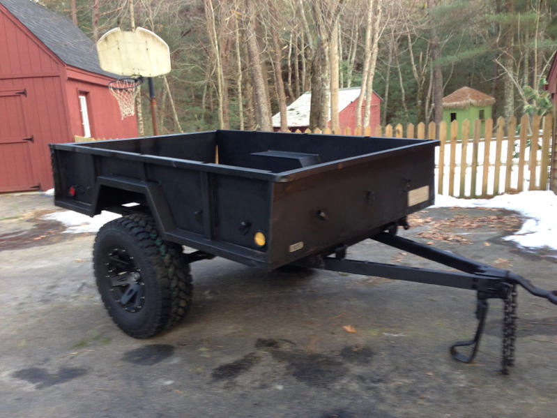

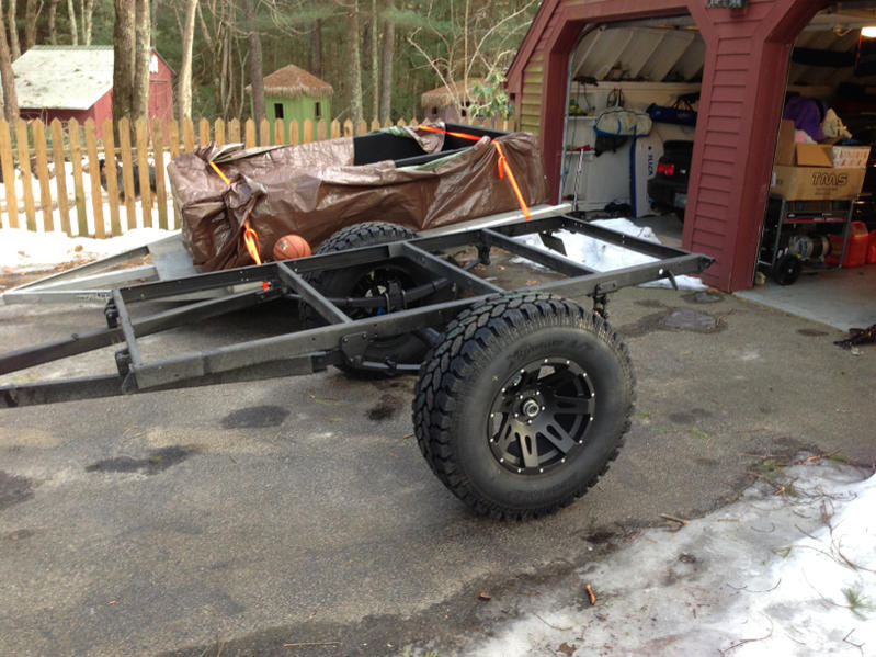

All primed and ready for paint and spray in bed liner. Then putting all details and extras on

Old Feb 22, 2013 | 02:15 PM
  #40
74CJ5's Avatar
Joined: Jan 2009
Posts: 1,423
From: Tampa, FL
The matching wheels look great! I plan do this on mine at some point.
