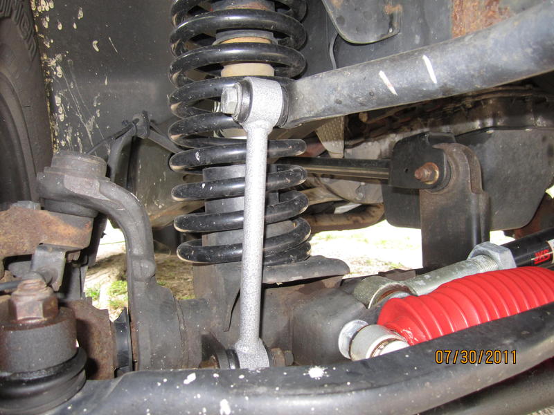

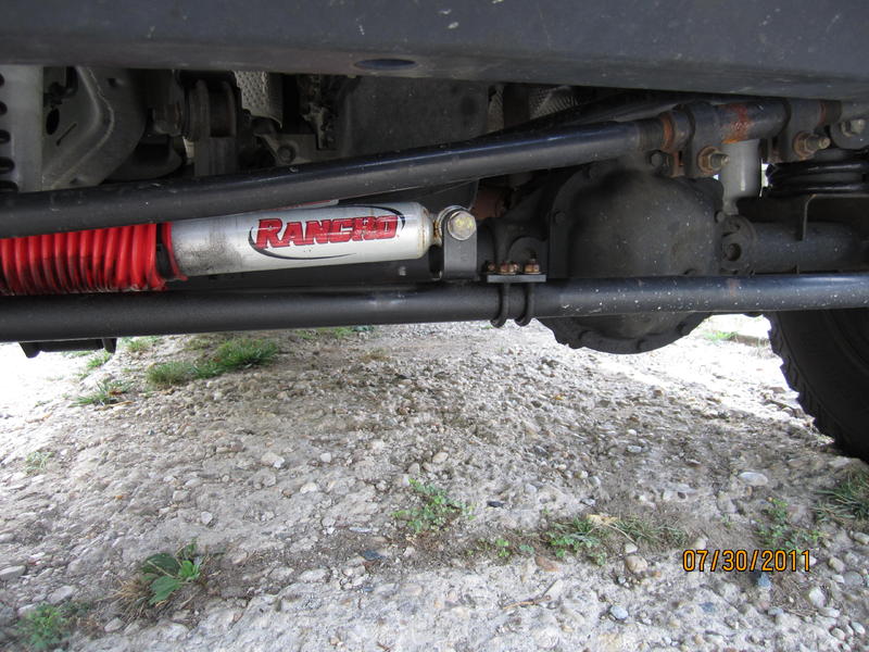

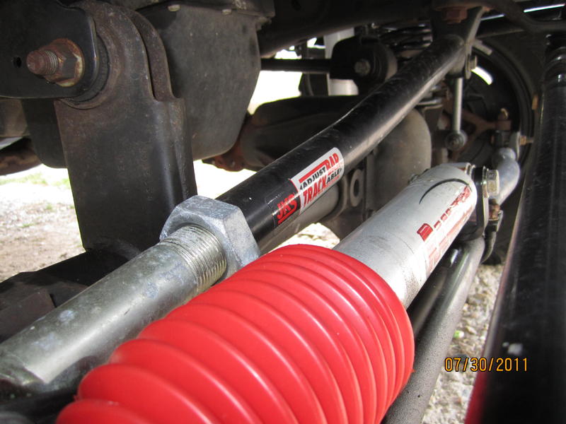

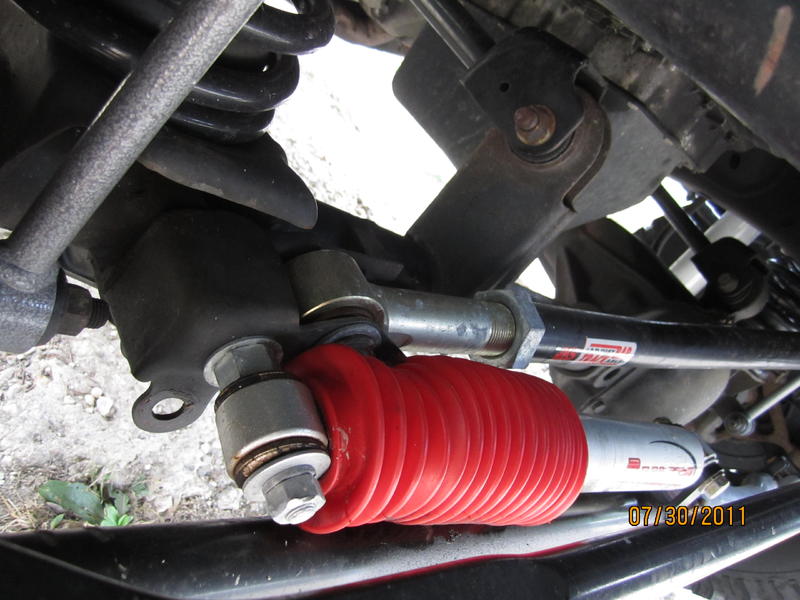

Ok here are the pics of the passenger side. Swaybar links are brand new for a 3inch lift all put on when the trackbar was put on. Thick grade 8 heavy duty washers on the trackbar bracket already front and back so the holes are not worn out. We are trying everything with no luck. He is going to retighten everything today again. Thanks again !!
I know what you mean about the death grip on the steering wheel white knuckles and all Also we already adjusted the steering when the trackbar was put on too.

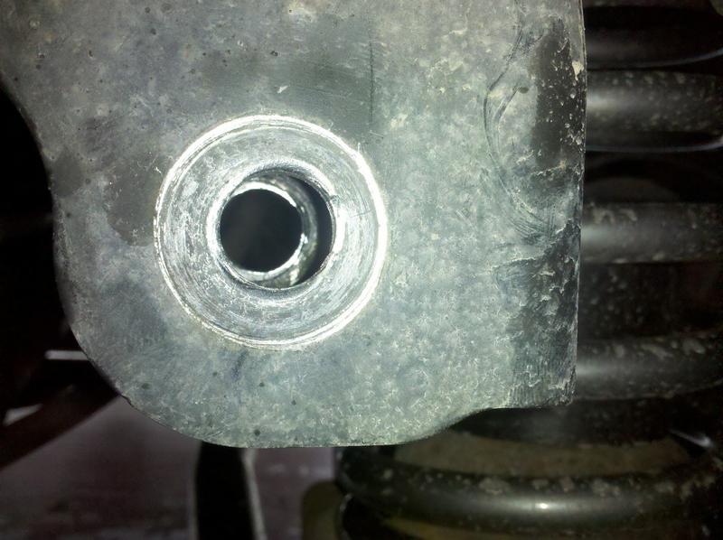

Well my wife had this issue while I was deployed and trying to explain what was wrong with it over messenger was a pain in the a$$. I told her take it to some one and have them check the frame side track bar bolt hole to see if it was elongated and every time she did they would just tell her the bolt was tight. She took it to a few other 4X4 shops and one told her it was the ball joint ($500) the other told her it was the tie rod ($500). It was nice they was trying to take advantage of her. Well luckily one of the members on here sent me a message and told me to have my wife come by and he would look at it. She k it over to his house and he checked things out. When he took off the track bar he found the frame side had been elongated. He recommended a Fab shop down the road and it ended up being a $20.00 fix. We haven't had any problems since
Here is a pic of the elongated bolt hole and the washer welded over the bolt hole.

Looking at the springs, and links, are u sure the axle is centered?? The spring looks to have a bow, and the link is not vertical.. Could be the pic idk, but I would make sure it's centered.... How did ur hub measure to center it???
