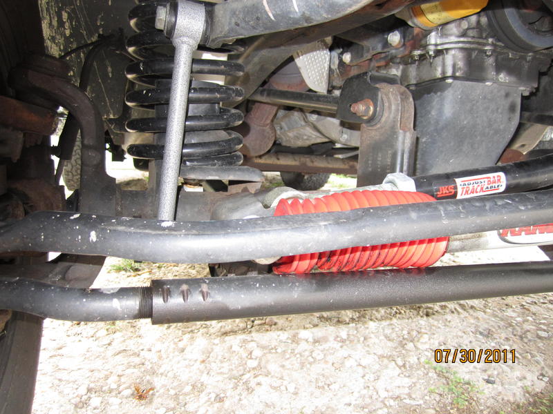

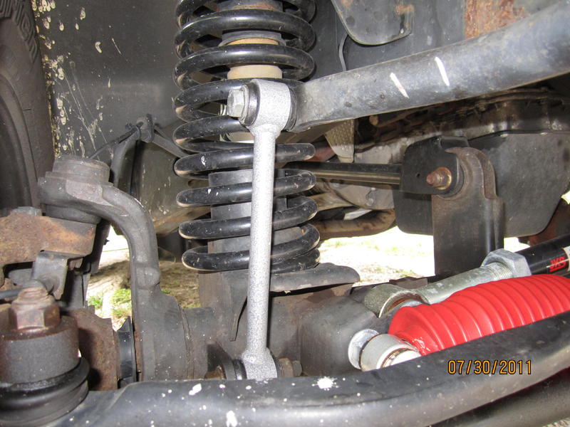

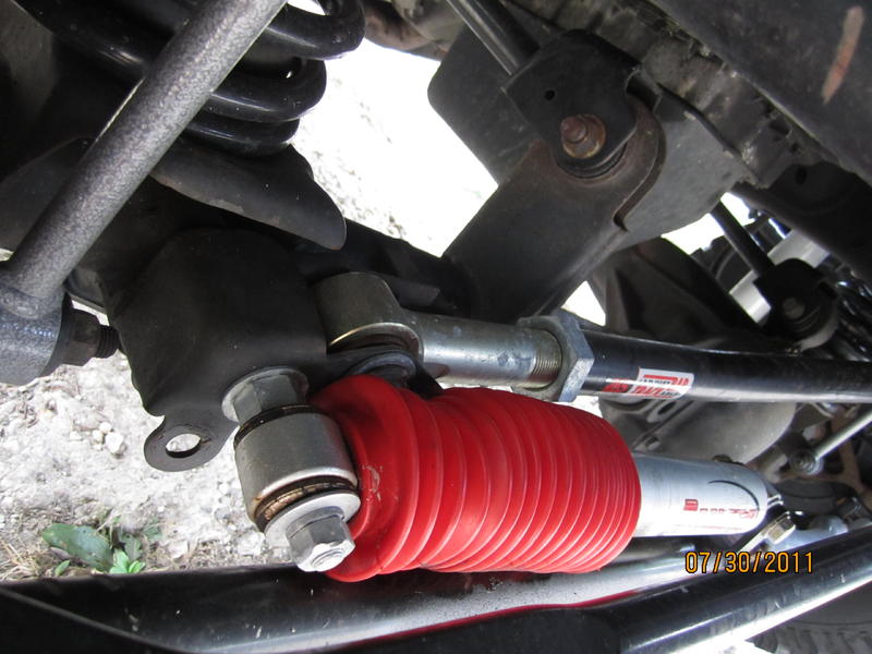

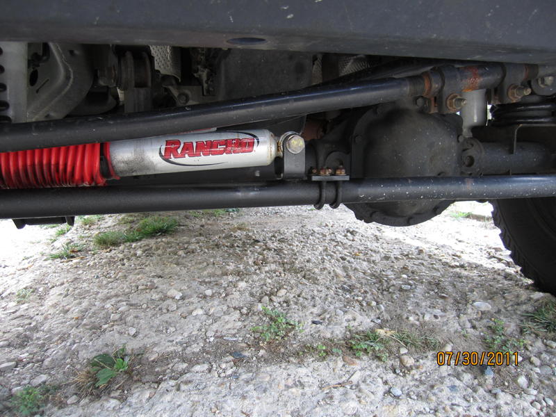

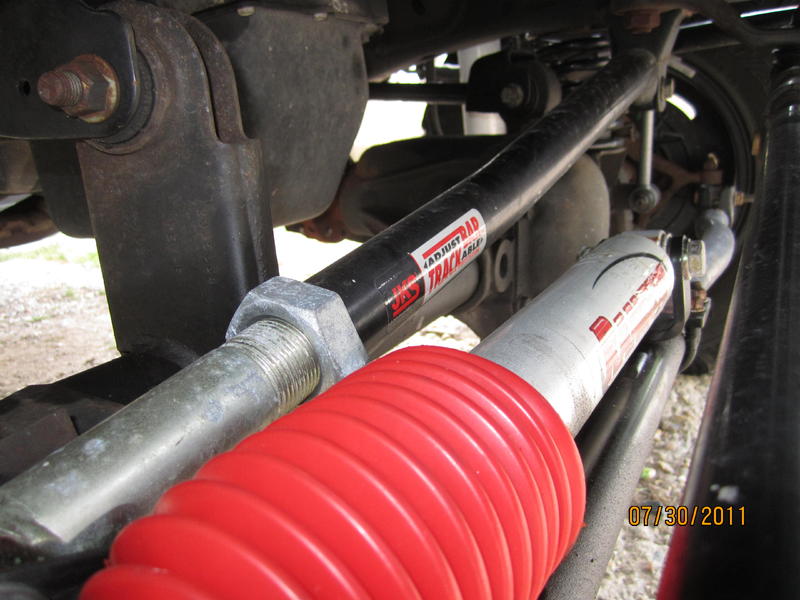

Originally Posted by kashlak
Ok here are the pics of the passenger side. Swaybar links are brand new for a 3inch lift all put on when the trackbar was put on. Thick grade 8 heavy duty washers on the trackbar bracket already front and back so the holes are not worn out. We are trying everything with no luck. He is going to retighten everything today again. Thanks again !!
I know what you mean about the death grip on the steering wheel white knuckles and all Also we already adjusted the steering when the trackbar was put on too.
Attachment 187827Attachment 187826Attachment 187825Attachment 187824Attachment 187828
Trackbar looks to be ok. I think the post about the wollered out hole was for the lower trackbar bracket welded to the frame. During DW the trackbar moves side to side and wears out the hole the bolt for the trackbar mounts to.
ok a few questions :
1.---- when the Trackbar was installed, was the jeep under its own weight sitting on the ground and then torqued ?
2.---- When the lift was installed, did the installers loosen all the control arm bolts and then re-torque them once the jeep was under it's own weight sitting on the ground when they finished the install ?
some people install a lift and without loosening the control arms bolts front and back (all 8 ) and then drive it, this puts the control arm bushings in a bind and sometimes twists them up. leaving the bushings in the stock position after a lift will cause problems and the rig will not drive right ( flighty feeling).
3.---- did you notice if the DW occurs when the passenger side front wheel hits a bump/pothole/RR tracks first ?
also,check your mileage compared to others here on the forum and their ball joint issues.
When you guys start re-torquing everything today......make sure the rig is on the ground.....lossen the trackbar bolts top and bottom and have someone bounce the front end of the rig up and down a few times ( i got on my bumper and did this) then re-torque the bolts to 125-130 FT.LBS. after 100 miles re-torque and again at 500 miles. if you loosen all the control arms bounce the front and rear then re-torque, and then do the trackbar. good luck

From the looks of it in the 2nd picture, it appears that the passenger side upper contol arm bushing on the axle is fairly dry-rotted. It could be that these bushings are worn out/rotted enough to cause the DW. Remove the UCA and use a long pry bar to move the bushing around to see how much deflection/movement there is in the bushing.

Thanks he still did not have time to look at it. When he does he just gets so pissed off at the jeep I will mention this to him I already had him read through the others and everything checked out as "yes that is what I did". Almost seems like you need to keep spending money just to figure out the damn problem This is so frustrating and it makes it worse since this is my DD not his
