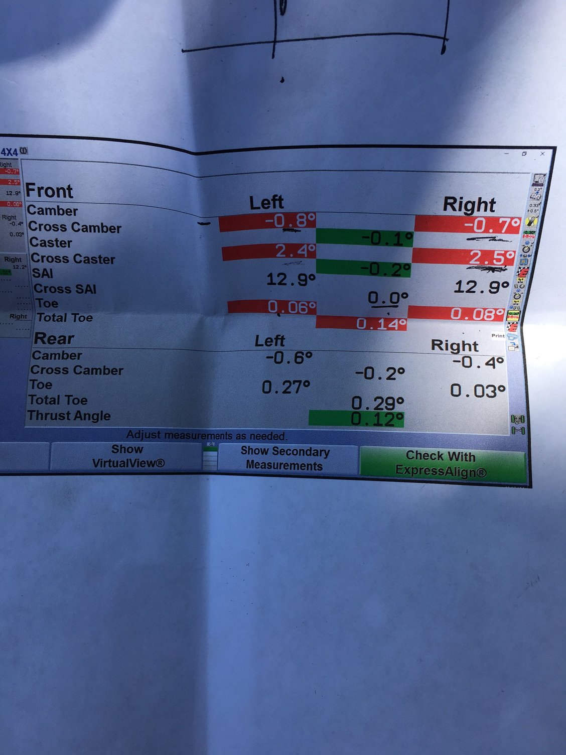

No caster correction? Would you happen to know the actual lift height gained from those 2.5" coils? Post the alignment specs.

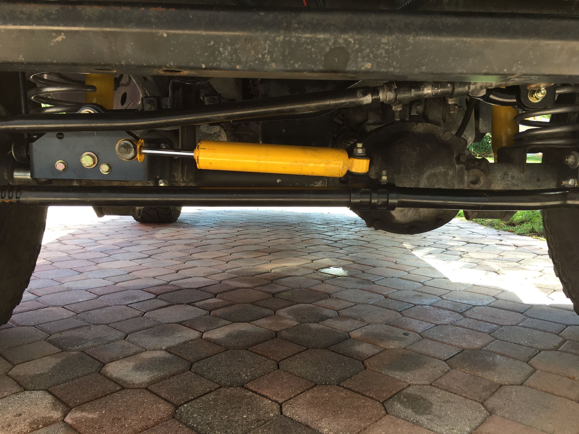

Yes I do have a track bar bracket installed to compensate for the flip kit. It was recommended that I have it if i was looking to lift the car further in the future which I am, just not at this time. Ball joints at least have gone 350+ miles for sure, even 500 could be a safe guess as on the first day I put in 50 miles alone trying to wear them in. Ill send a photo of the suspension to my car when I get the chance as im at work atm (the best I have is this photo of the passenger side before I swapped the bolts and TB for the RC TB, but it looks basically the same). Im worried that I may have a damaged steering box from the wobble when it originally happened (is that possible?). Also could the flipped drag link cause the issue for the lift I have, what would be the reason for that? Considering the track bar is also on a bracket.

Can you post up the alignment specs? Curious what your caster is.
Here is the alignment specs. Mech says the Caster is a bit low and could affect handling on car.
Better shot of underside of car, you can see that Track bar and DL are pretty close to parallel. We also shook steering wheel while the vehicle was off and didnt find any play.

Oof, that caster is definitely low which can't be helping things any. Keep in mind that caster from the factory is 4.2*, and most of us lifted guys are running somewhere in that 4-5* range (it's not an exact science). Caster is one of those things that small changes make a huge difference. Since it's that low, have to think you have no form of caster correction. The easiest/cheapest solution would be to throw some control arm brackets on it for $100. It would make a big difference in that regard. Low caster can often result in bump-steer (hit a bump and steering wheel kinda yanks in a direction). I could envision this being a combination of bump-steer with effects of tight steering still.
When you make a turn in the jeep currently, does the steering wheel want to return to straight by itself? If not, those ball joints are still tight. The description of constant correction between 11 & 1 o'clock sounds mainly like tight steering still following BJ replacement to me.
