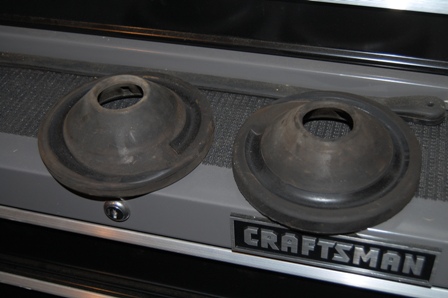

He said the isolaters are sitting in the back of his jeep. Mystery solved. If they're there they can't be on his coils at the same time. They need to be put on between the spacer and the coil....

They left two "original" parts (isolators) in the back of my Jeep.
I missed this comment too, like the poster above just mentioned. Then you should put them back in. The stock isolator will probably not make a whole 3/4" difference, but a good 1/2" at least.

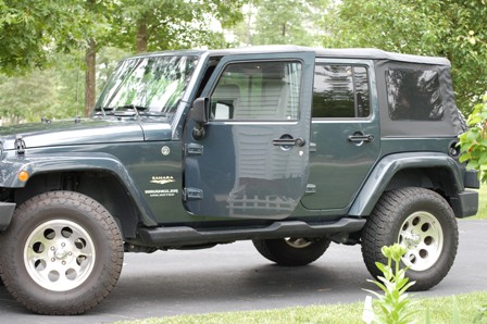

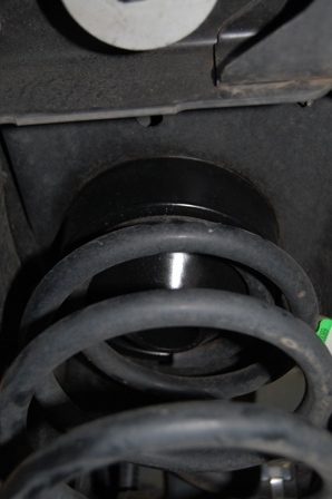

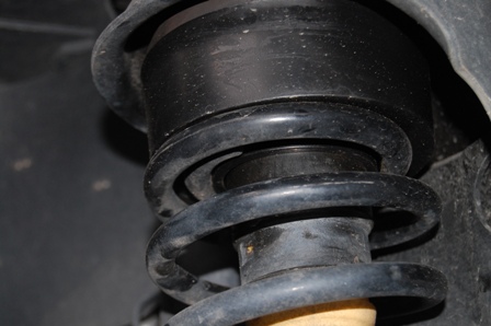

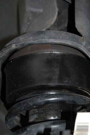

Ok, it looks like they put the stock isolators on the top of the 2" spacer - and on the rear they removed the stock isolator and left them in the back of my Jeep. Should I take it back and have them reverse the spacer in the front or does it make that much difference?

man they screwed that job.. it should be swapped. the teraflex spacer doesnt sit well under the stock isolator.
of course you should also have the rears in.. but that will make your rake even worse..

Those rear isolaters are supposed to be on the rear tf spacer. Take it back and tell them to read the instructions.

i would go back and complain at this point. the directions clearly state how to reinstall the factory isolators. have them correct the front and add a 1" spacer and then have them reinstall the rear isolators. hard to see in the pics, but it doesnt look like these are TF spacers. if you paid for TF, make sure thats what they used. did they install a 1" in the rear and 2" in the front? the problem with not installing the rear isolators is that the coil will end up digging into the spacer over time. i have seen it happen.
edit... ok, the rears definitely look like they are NOT teraflex. im guessing the fronts arent either. with the rears that they used, i dont think the factory isolator will work, as its missing the center guide part that would allow the isolator to slide on to make a good connection. again, if you paid for teraflex, use teraflex. at this point, since they didnt get you want you wanted, have them remove the ones they installed and install the TF ones.

the design is clearly different than TF. and on top of that, you didnt get what you wanted to achieve in the first place, which was to get rid of the rake, correct?

The spacers do appear to be 1.5 and 2.5 so it's strange your JK isn't level. By the picture it's easy to see it isn't .. the spacing between the front tire and fender should be larger than the spacing between the rear tire and fender. Yours look about the same which is the factory rake. If they left the rear Isolators in it would be even higher in the back. Bizzare.
