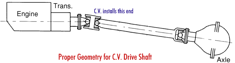

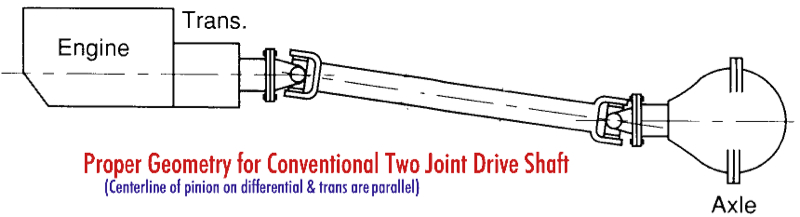

The stock Rzeppa and aftermarket double cardan require different pinion angles which is easily seen via the front pumpkin

I was always told its the same for both but the Internet can be a lier

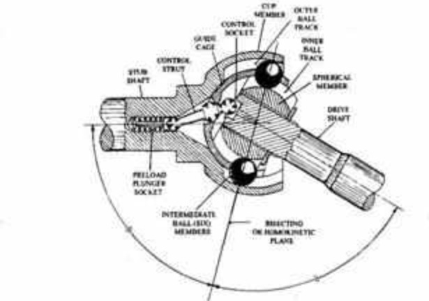

According to what I've been reading on rzeppa joints they areade to handle big angles....
Rear propshaft. A double offset (Rzeppa) CV joint is shown in the photograph below of a rear propshaft connection to the rear axle of a 2010 Jeep Wrangler Rubicon. This type of joint can handle larger operating angles (10 degrees) as compared to U-joints (5 degrees).
http://www.vibratesoftware.com/html_..._CV_Joints.htm
