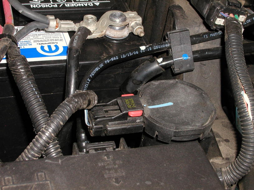

Old Oct 1, 2008 | 06:24 PM
jkboz's Avatar
Joined: Aug 2008
Posts: 11
From: peoria,az
Originally Posted by wrnglrguy
Can you post a pic of this line to get an idea of exactly which one you mean?
hope this pic comes through.
