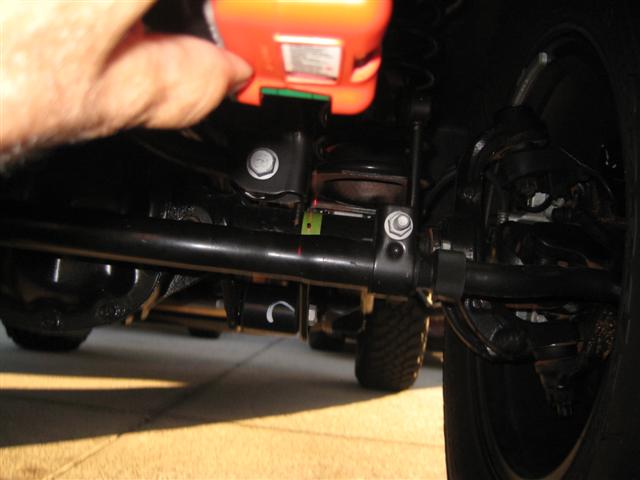

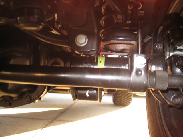

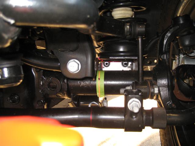

Name:	Lift 001 (Small).jpg
ID:	576267Click image for larger version
Name:	Lift 003 (Small).jpg
ID:	576268Click image for larger version
Name:	Lift 002 (Small).jpg

Meh. Factory tolerances don't make that any more or less accurate IMO. If you want precision, I would measure left rear to right front and then right rear to left front. Square to the frame is what you want and all carpenters know that measuring the diagonals is the best/simplest way to check square.
Edit: Actually when I did mine I was starting with a factory centered axle. I used a laser to mark the axle before I installed the lift and then adjusted it back to that point.
