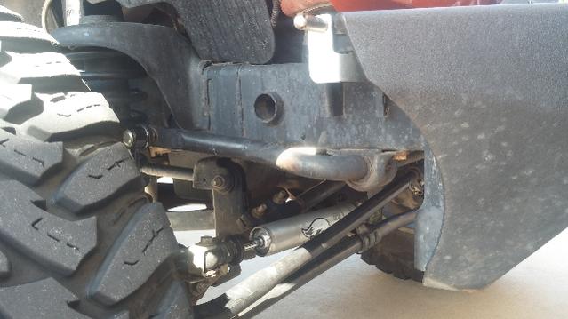

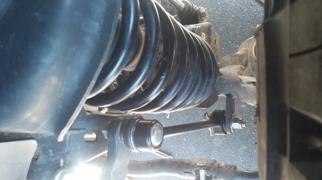

Here are a couple of pics of how my teraflex swaybar links look with the adj trackbar aligned and springs in their perches. Still in close relation to the spring but not contacting. Everything rides great and measures equal from side to side (body in relation to axle).
The adjustment of the trackbar sounds more daunting than it really is.. you will understand how it works as soon as you start looking at the unit and how it extends and retracts. As soon as you unbolt the trackbar from the axle bracket, have a friend rock the jeeps body back and forth a lil bit and you will see how the trackbar holds the body centered over the axle. Its a cool mod that doesnt take much time but gives a better understanding of how your jeeps suspension works.
