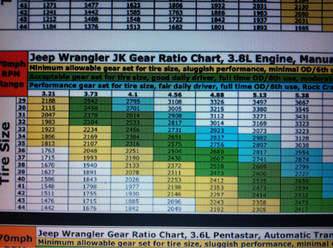

Ok terminator, in the chart in the FAQ page it clearly shows optimal gear settings. Check out what it shows for my 2008 6 speed manual with 321 and 33's. Nowhere does it say down shift and you'll magically have 538's.
It appears that you are not driving a six speed manual, nor do you have 321 gears. And you are giving out misinformation. Bc anyone who is running the 321 and 33's manual will tell you it ain't ideal.
Idk why you would try and tell someone what they should do if your butt ain't in the seat of a 6 speed with 321 gears.
Even WOL said that if he has 373 he may be ok but might still want new gears. But I guess we are all wrong and you know what's best. And we just don't understand
