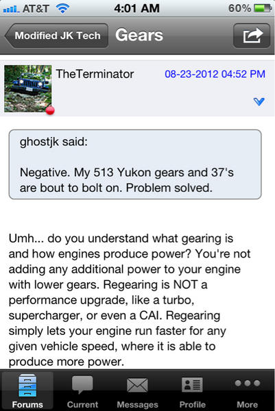

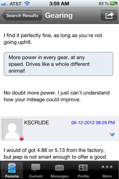

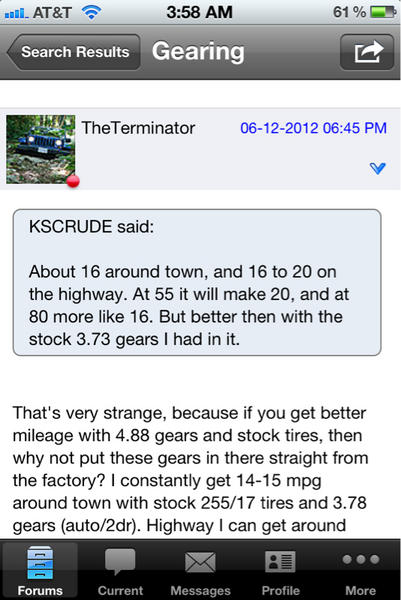

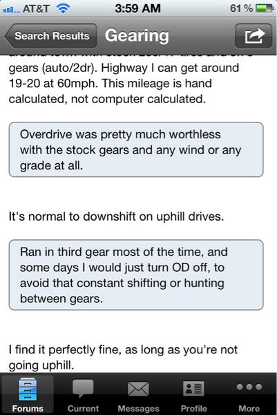

@The Terminator you just posted in one of your earlier post criticizing me and saying that regearing gives you no more power. I just came across a post you made two months ago claiming that regearing gives you more "power". So which is smart guy.

Oh, so you are that guy that wasn't happy even with his stock tires and gearing. Now I remember you. Well, now I'm even more assured that you bought the wrong vehicle. There are 2 type of JK owners, those that feel the stock JK performance is fine, and those that don't. You fall in the 2nd group. Anyways, what I said was that regearing doesn't make the engine more powerful in itself, but because it runs at higher rpm's, it can generate more power (that it already had) at any given vehicle speed. Understand? As far as stock gearing and higher rpm, I am now convinced that Jeep should have went to a lower stock gearing for all pre-2012 JKs, as higher rpm's actually help more.
