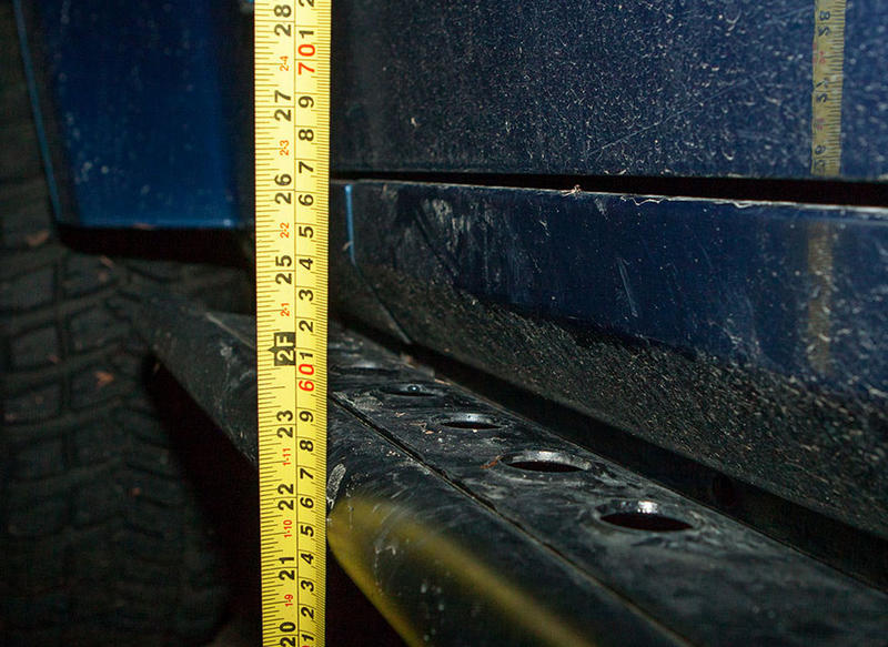

I took measurements of my LOD sliders. I'm on 2.5" lift and 35's:

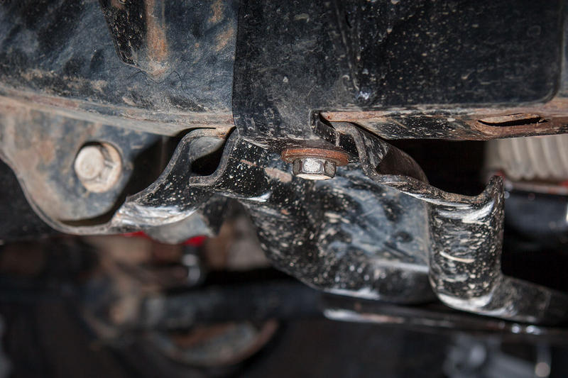

They definitely can be used as a step. My wife uses them all the time. They can be welded on if needed. The only thing to think about is what to do about the auto transmission skid plate, as it mounts above the slider:
You would need to keep the skid removable as one day the auto tranny will need to be serviced.

Thanks terminator for the pics. you are right about welding them , and the concern for the tranny skid , but I have replaced it with heavy duty one. Still , if they were welded on , I could simply cut off the tab that bolts to the tranny skid plate.

Might not have to cut anything, just loosen bolt and slide it out.. maybe?
You're totally right, best thing is just to cut off the tab if you're welding them

You can't slide them out unless you also lose the bolts on the side of the frame. The sliders need to move away horizontally a bit to slide the skid out. I think you could always mount the skid plate under the tab, but then you're sacrificing some clearance, which could be a turn off for some. As mentioned, cutting it off would be the best option. Didn't kind of think about it
