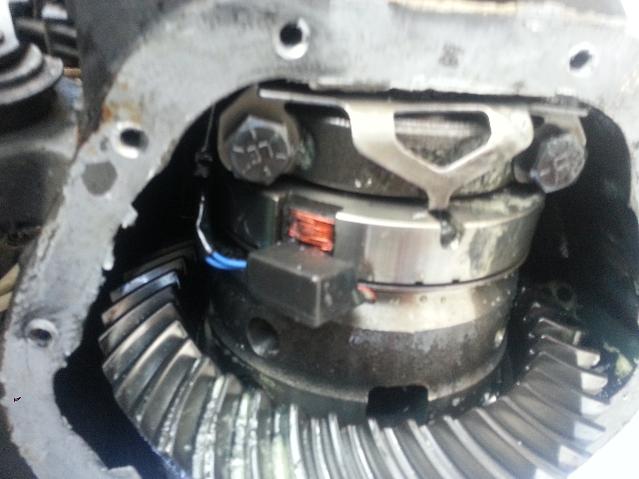

Well decided to just jump into it... and so far im here...

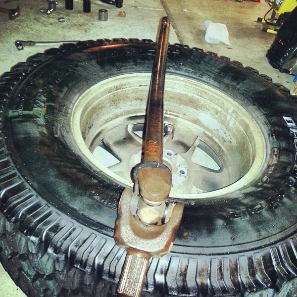

Also found out my axle shaft is bent...
Old Feb 14, 2013 | 01:52 PM
Sgt Mack's Avatar
Posts: 1,234
From: O-SIDE
Ouch. What shaft is that?
Old Feb 14, 2013 | 01:53 PM
blkpearl_jk's Avatar
Joined: Feb 2013
Posts: 49
From: oceanside,ca
Passenger side
