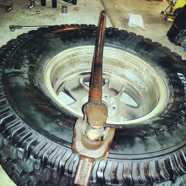

Originally Posted by blkpearl_jk
Also found out my axle shaft is bent...
Attachment 422272
There's reason enuf for a seal to leak. . .
Yes sir, thats what I figured. ..

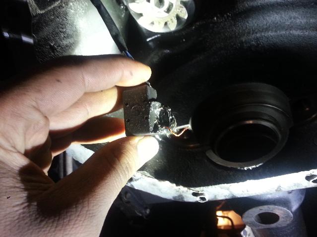

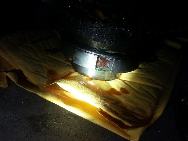

Ok can anyone tekl me how bad this is?? It was already broken off when I open the deff cover

Old Feb 14, 2013 | 06:38 PM
ronjenx's Avatar
Posts: 12,906
Likes: 185
From: Maine
Attachment 422375
Attachment 422376
That means you need a new locker, or the good magnet off a locker that was broken in some other way.
Old Feb 14, 2013 | 06:41 PM
blkpearl_jk's Avatar
Joined: Feb 2013
Posts: 49
From: oceanside,ca
Originally Posted by ronjenx
That means you need a new locker, or the good magnet off one that was broken in some other way.
Thought that what it was... I can still thorough it back in that way right? Just won't have front lockers? So I need to find a used one with a good magnet and switch it out?
