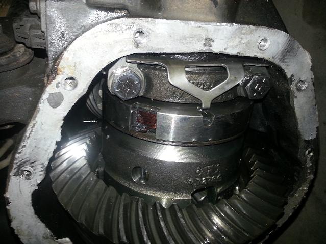

What was the condition of the tab on the anti-rotation plate when you removed the cover?

From: oceanside,ca
It was bent back nit seated in like the ine in the picture. .
Old Feb 14, 2013 | 07:16 PM
  #25
ronjenx's Avatar
Posts: 12,906
Likes: 185
From: Maine
That's the source of your breakage, then. The magnet was allowed to spin.
It usually just breaks off the wires, though.
Has your differential ever been apart in the past?
How about a pic of the plate?

Posts: 49
From: oceanside,ca
The online time its been open was to change out the deff covers

Posts: 12,906
Likes: 185
From: Maine
Attachment 422387
The tab definately didn't keep the magnet from rotating. I've seen this a few times before, but why the magnet rotates with enough torque to displace the tab is a mystery.
