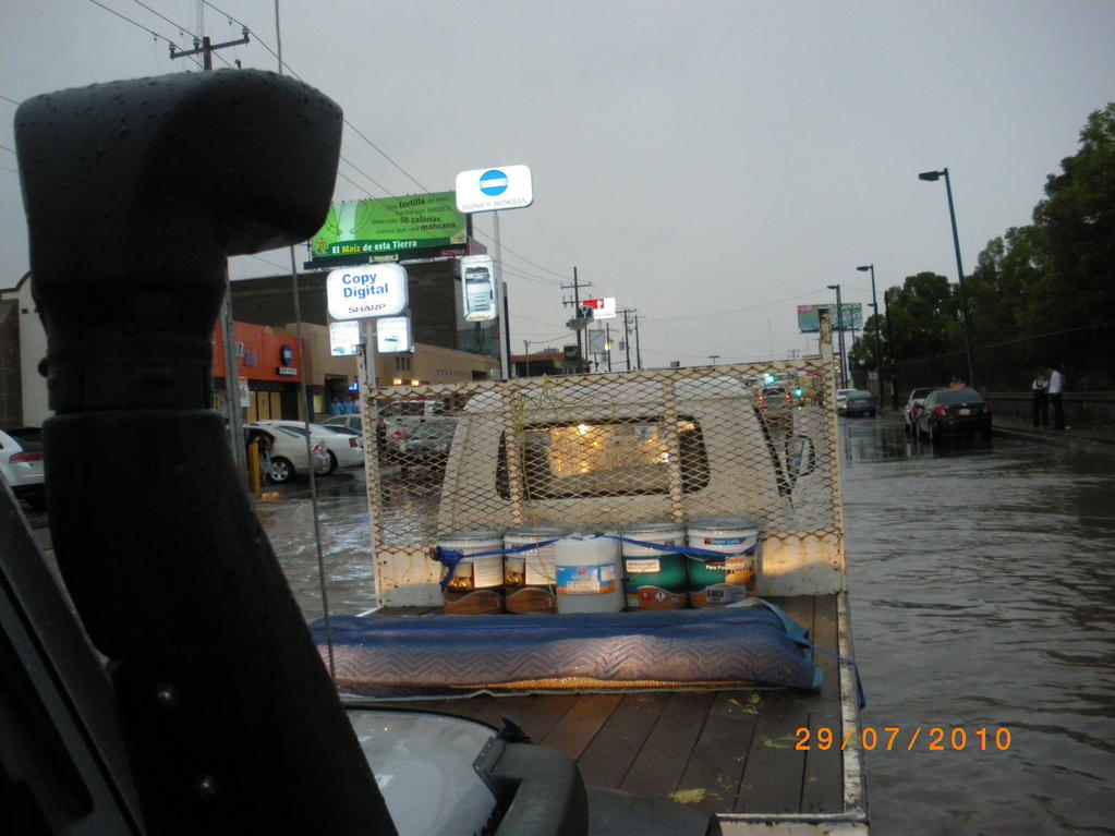

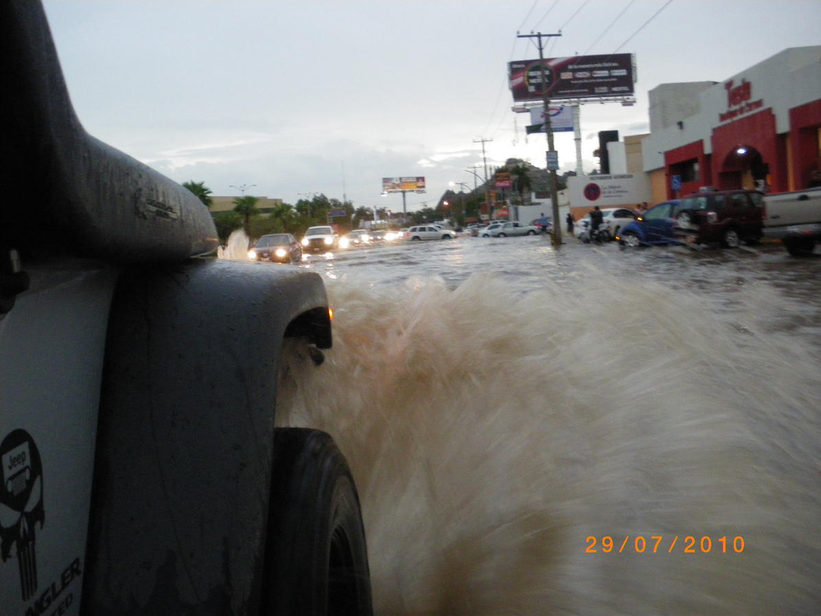

how i look at my snorkel is that it might as well be a CAI. it pulls cooler air in from outside the HOT engine compartment. it just also happen to help protect my jeep from being hydrolocked when i am out playing in the river, or when the river comes to me like it did yesterday in a freak rain storm that hit my area. better safe then hydrolocked is what i say

but if you play in water, it is a must, trust me, do a search on hydrolocked jeeps and you'll quickly come to the conclusion that one is needed if you like water sports
