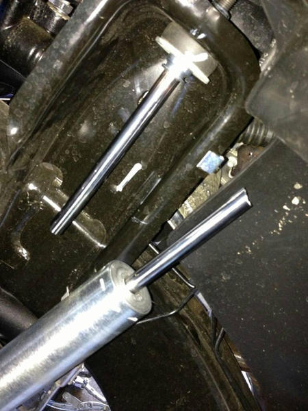

Old Jun 8, 2013 | 09:27 AM
JK Inspired's Avatar
Posts: 643
From: Westfield
Bilstein 5100- no thank you
Old Jun 8, 2013 | 09:37 AM
Delux2769's Avatar
Posts: 2,681
From: Quinlan, TX
Originally Posted by JK Inspired
<img src="https://www.jk-forum.com/forums/attachment.php?attachmentid=465954"/>
In all the threads that I've looked at over the years, that is the first I've seen of one of those snapping like that. I've heard of valves going bad, but the company has sent a free replacement for everyone that I've heard of.
