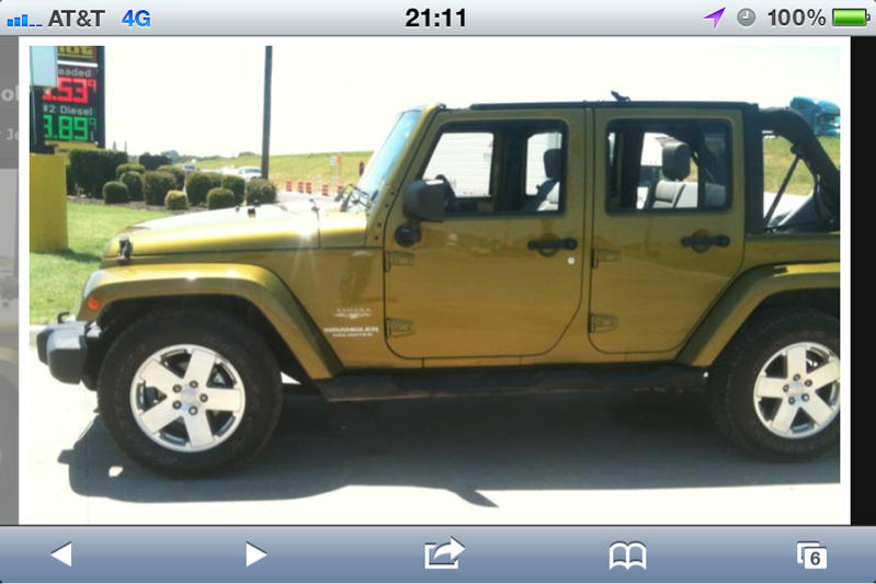

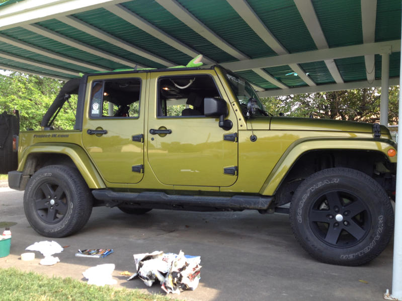

I call BS. 14/55 springs on my '08 JKU is what came stock. After installing 18/58 springs from another JKU, I gained over 2".
Here are before and after photos of that change:
True shocks do not provide lift. But anyone who says Rubicon shocks don't make a difference is a liar. Switching from my Black shocks to Rubicon Take offs, the ride was much smoother. Even my fiancé noticed the difference between shocks.
